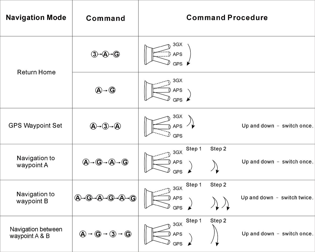

Align's APS system (Competitor to WK-H) uses a single channel to switch all these functions, including setting waypoints and initiate auto waypoint flights. The way they do it is to use a 3 step switch on your radio, and certain sequence will activate certain function as shown in the table.

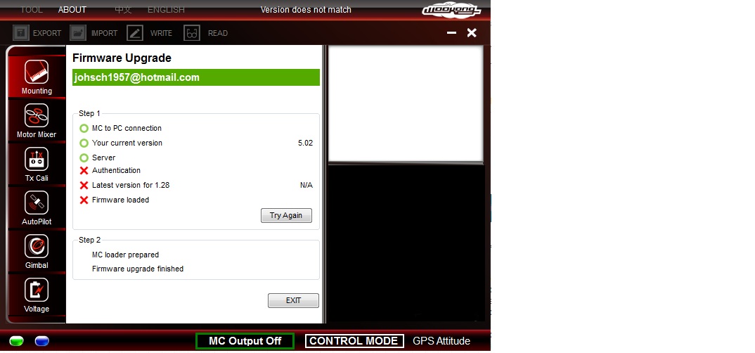

It doesn't work.
8DQO94BOek7C4AAAAASUVORK5CYII=
Hi johsch, I see you are on 5.02 at the moment, I upgraded my HL hexa to 5.06 a while ago but had big problems with ESC overheating and causing one to shut down resulting in a crash. I'm now reluctant to upgrade to 5.10 (especially as it’s an "evaluation" release), I would be grateful if you do a successful upgrade to let me know your findings.
Regards
Andy
