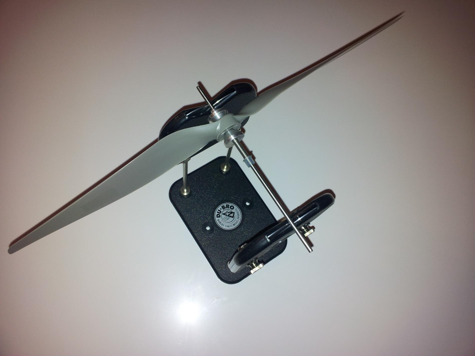

Hi Mark, I've used quiet a few balancers only to find out none of them were 100%, untill I splashed out for this baby.
View attachment 2429It's a DU-BRO
Cheers
Rob

+1 for du-bro
Don't go near the hobbyking balancer. You'll be chasing balance and waste hours of time wondering why the are out of balance all the time.

I really like the Du Bro. Had several other one and most of the time one important aspect is forgotten. The axis on which the props are being balance has to be 100% level so horizontal otherwise the whole balancing act in my eyes becomes useless. Some of those magnetic balancer although close to frictionless just don't provide that.

I've been buying balancers for 20 year for aircraft from 100cc acrobats to jet fan blades. The Dubro is great for large props, anything from 10" to 30" blades. The problem is with smaller and lighter props. For that you need to use a magnetic balancer as the Dubro has more friction. In either case, treat the shaft very carefully. Especially the magnetic units and they utilize a softer material to help with magnetic attraction.
