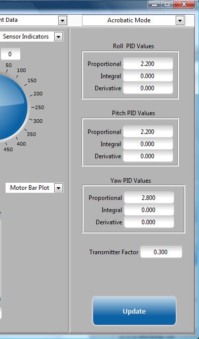

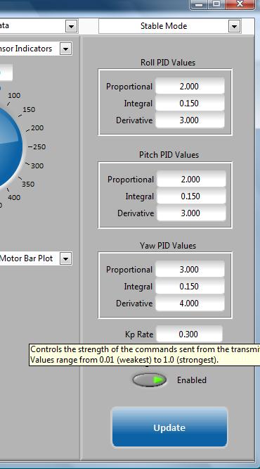

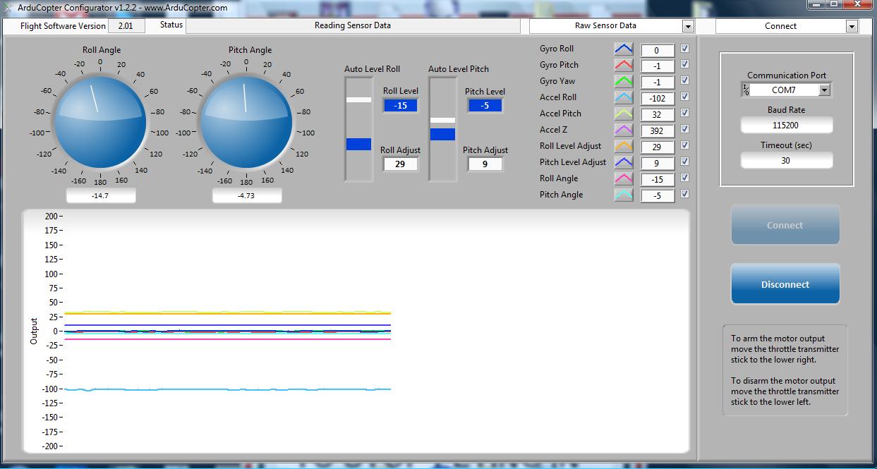

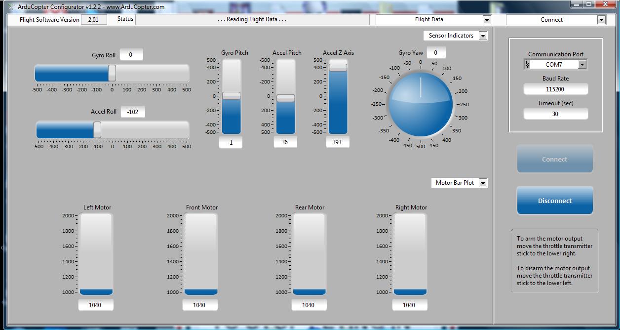

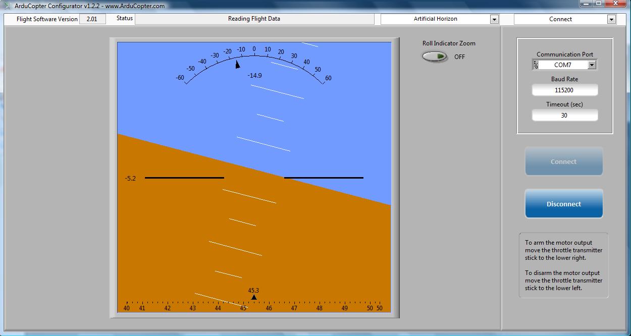

I am about to tweak the settings on the other laptop, so will take some screen shots of the different pages in the configurator
matwelli
