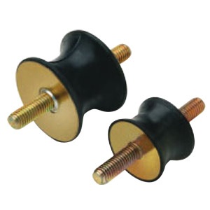

In that other thread there was a lot of talk about reducing vibrations. Balancing props and levelling motors. I have seen the kloner vids on levelling. Has anyone tries something like this between the motors and motor mounts to reduce the resonance from traveling down the arms?

not sure how you'd work those into your motor mounts

The logistics would be easy. Cut 4mm stud to lenght and loctite into motor. Feed other stud thru motor mount slots and put a nut on back side. Just thinking out loud here.
If I get superx I can do a vibration analysis with and without.
i use something similar, neopreme anti vibe stuff from mc master carr
