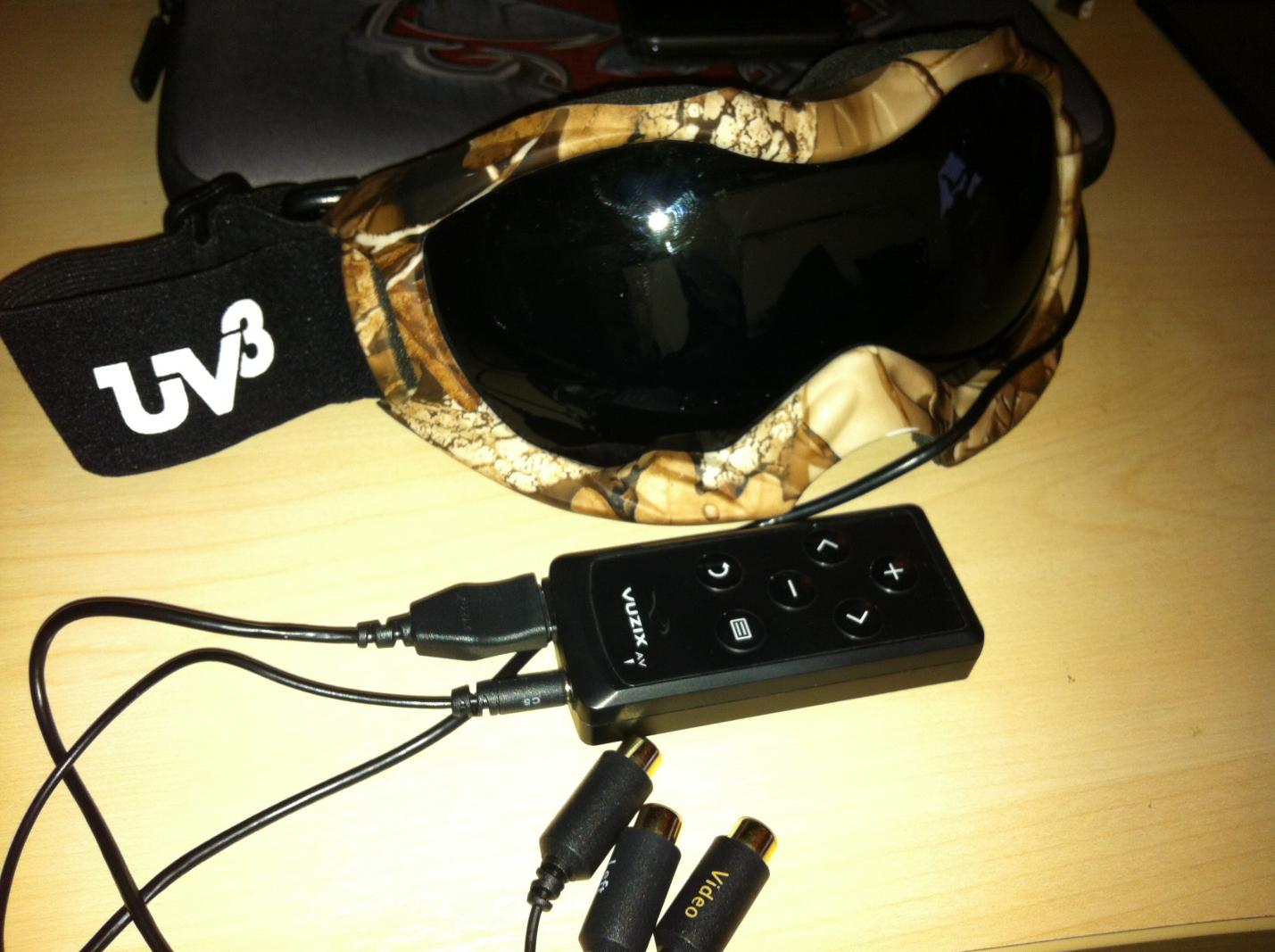

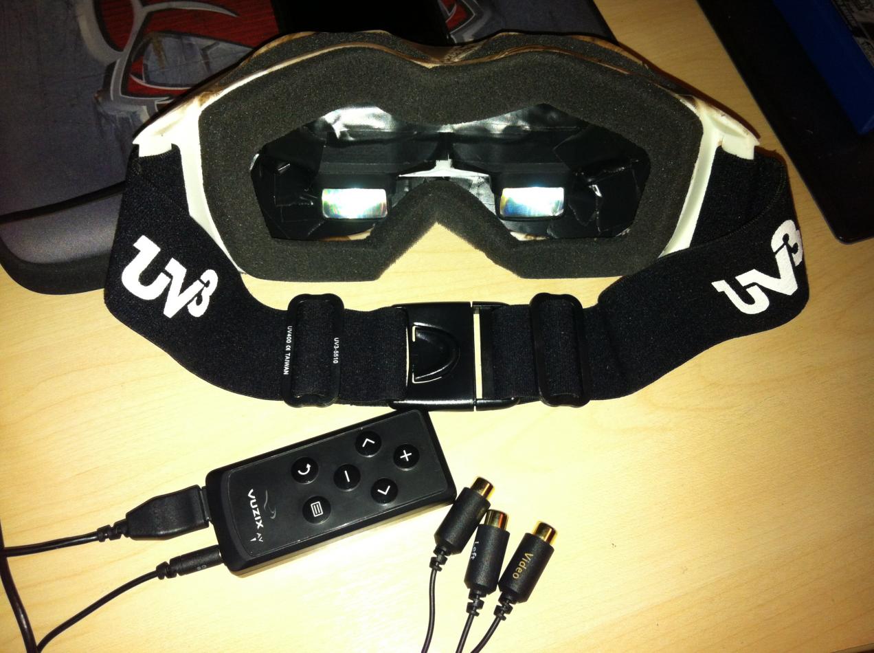

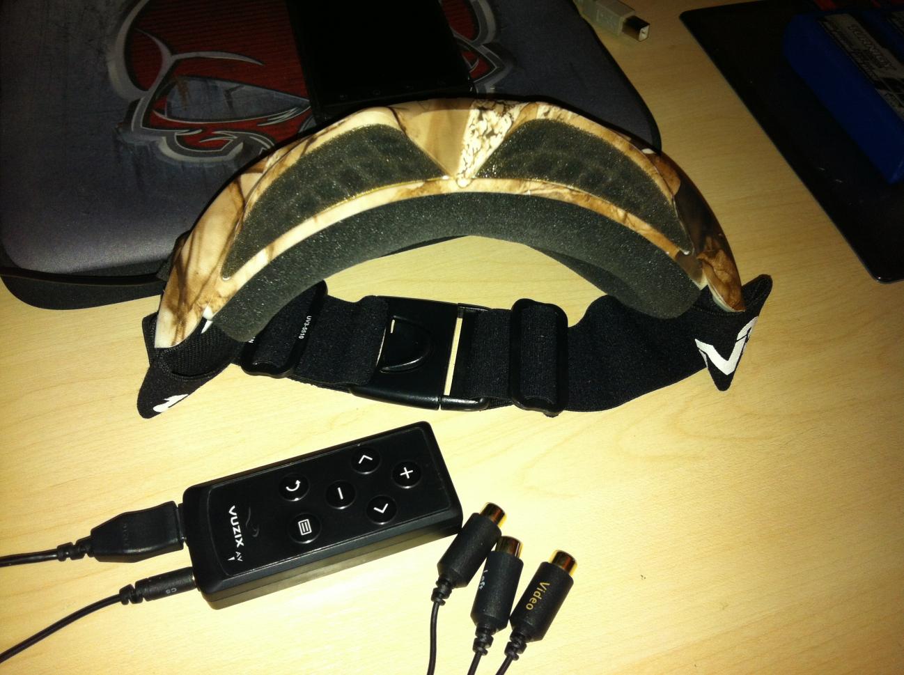

well i seen you lads doing it with fatsharks so i tryed it with some cheap vuzix i got hold of :)
wen i got the 920 wraps from vuzix i found that the screens are too close together for my eyes... and from what ive seen on the vuzix forum
im not the only one with this prob..... so ebay for a cheap ski goggles and a hack-saw lol i took them to bits and cut the black plastic in half that holds
the screens and then made them fit my eyes by making them 5mm apart... some gluein, and put back together and 20minz later and i have something that works better :)
just need to get out to play now
best part is they dont weigh anything and they all fit into the goggles :)

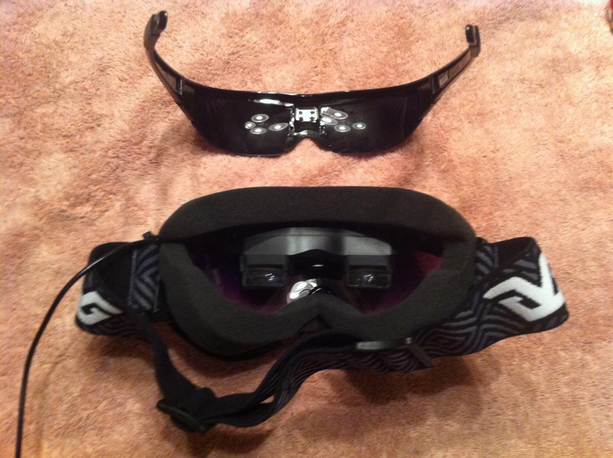

Thanks for the inspiration. I went out today and bought some ski goggles on sale, end of season you know. I did not cut through the lens but bought some goggles that were meant to be worn over glasses. After I removed the screen unit from the glasses, it just unclips from a mount, I positioned them inside the goggles and used some velcro. I did zip tie the cord to the strap attachment. Now all I have to do is black out the rest of the lens. I may use some electric tape vs painting them. Looks great and functions just as well. The best part is I can revert back to the original set up if I want to.

I tried them this morning and they were great! I just taped over the top vents to seal out the balance of the light. Very comfy vs anything else I have tried.
I wound up stuffing mine into the same exact goggles ed has, made for fitting over glasses. never even tried em this weekend, got stuck to the 22" monitor
on the fatshark if the lens isn't rubbing your eye lashes, you don't get the periphrial thing going right and gotta look around. kinda nerve racking with all those circuit boards so close to my face though. used black paint on the inside before put it all in, totaly dark
