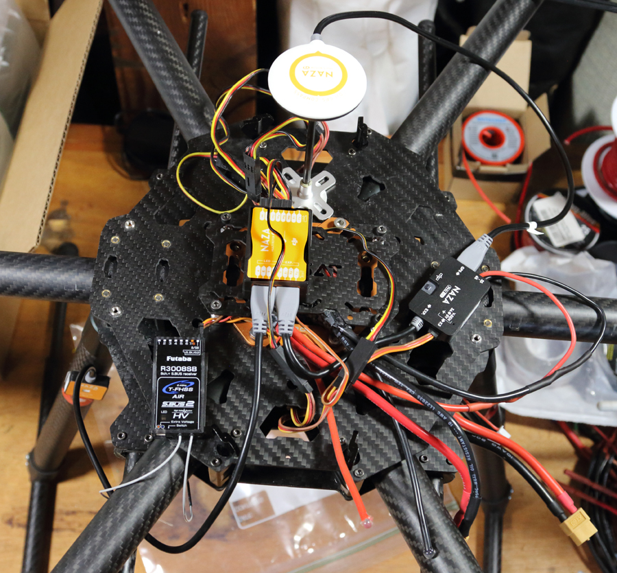

Took apart my ebay steal the tarot T810. Check out the pics.

Everything was going very smoothly until I connected the flight controller with my computer. Apparently there were issues with window 10 computers communicating with the flight controller. There's a great online tutorial that shows how to properly download the files into specific folders. Anyway, after I did that I was able to test the motors. Law of probability would dictate that half the motors would spin the right way and the other half the wrong way. Of course every single one of my Motors were spinning the wrong way. After switching the wires around all is good. Now to figure out my Futaba remote control. It is a little tricky getting all the channels set correctly, after all, this is my first build and first real remote control.

This is it! Everything is in place. Transmitter programmed.... I think. I will fly it later today if all goes well and will hover it in place for a while to make sure the used motors and ESC's are ok. Will clean up wiring if successful. Can't wait. Any last minute advice is welcomed.

The 2nd flight was pretty normal, but pitch and roll need to be turned down. It feels like it would flip over if I pushed the stick too much. I'll have to find where that is, remote or Naza M V2 program.
After the 2nd flight of about 7 minutes, I checked all the bolts and some may have loosened up although I am not positive that is the case. I didn't check the props but will now. This thing is really a monster.
