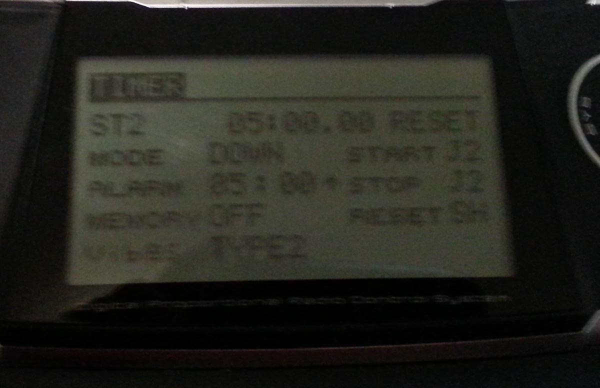

Gaaargh, the timers on Futaba's are a bit of a pain to set up but I have two set on my 14SG, a count down that sets off an alarm and them a count up timer starting when my throttle goes up past a predetermined point and stopping when I reduce throttle to zero, for reset I use the trainer switch,, 8FG is the same to set up I think.
I can post some screen shots if you like.

Here is a couple of grabs from the timers on the 14SG, not sure if they are the same as what you are asking about, I have an 8FG coming soon but don't have one in front of me.

Just tried setting up the timer for the throttle, works great, thanks again.
