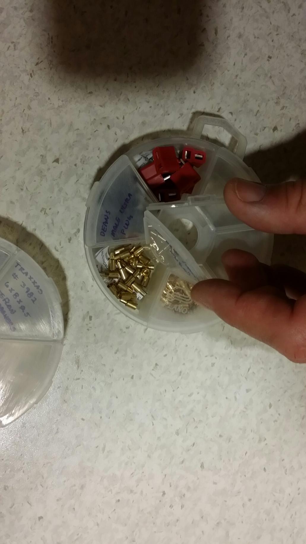

All this for under $100 shipped. Sounds like a lot huh? Now consider sitting at home, and realizing you lost or are short a single connector. Now you have to run out and purchase a single pair (etc) for 7.99 locally. Factor in fuel, etc. I'd rather spend that money on some other upgrades. One thing I've learned about RCs is when you identify you need something, purchase it in bulk, and hopefully BEFORE you actually need it. Those 12 bullet connectors I paid "Hobby Store Prices... Cost me nearly $30...) Annother annoyance, when I ordered my F550 they wanted 1' of 10ga "silicone" wire for $10... 10$ A FOOT!!!!!!! I pay (because I buy in bulk) 10$ a foot of SINGLE OUGHT WELDING CABLE!!!!!!! Once again... Because they can.
I love realizing I need something or a friend calls up asking if I have it, and I walk over to a bulk pile I've got pre-sorted in a tackle box and grab what I need. If a friend needed it, the look on their face almost makes it worth while. Plus, you can offer them a discount from what "retail" is, and you are still making money!

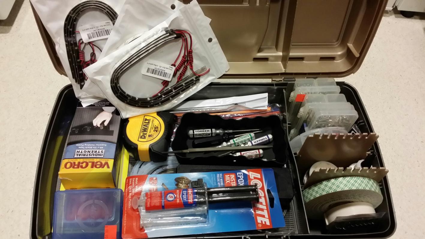

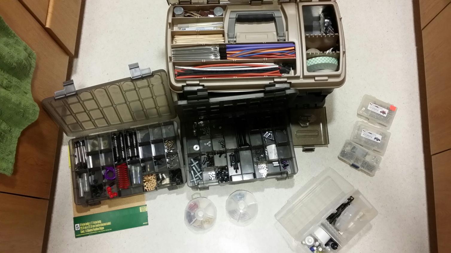

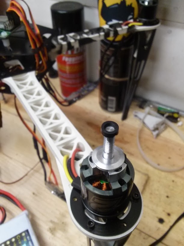

7808
thanks for the help guys. i have the motors, esc's, and battery wired up, i have the ESCs connected to the kk board, last night i figured out that the board is powerd by the ESC, and i cut and solder in 2 small wires off my power distribution harness so my KK board can monitor voltage.
where i am stuck on the whole build is the reciever to kk board wiring. i've found 10 pictures like the ones you guys posted, i still dont actually understand which one of those is ch1 ch2 ch3 etc lol or what to connect the BATT pins too on my (HK 6ch) reciever.
also stuck on mounting the props, none of the rings that came with my slow flyprops seem to be the correct ones for my motor shaft/prop combo. there is some that ALMOST fit but i would have to really push them hard onto the shafts or drill them out a little

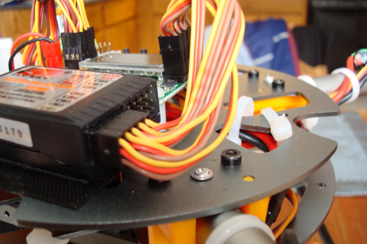

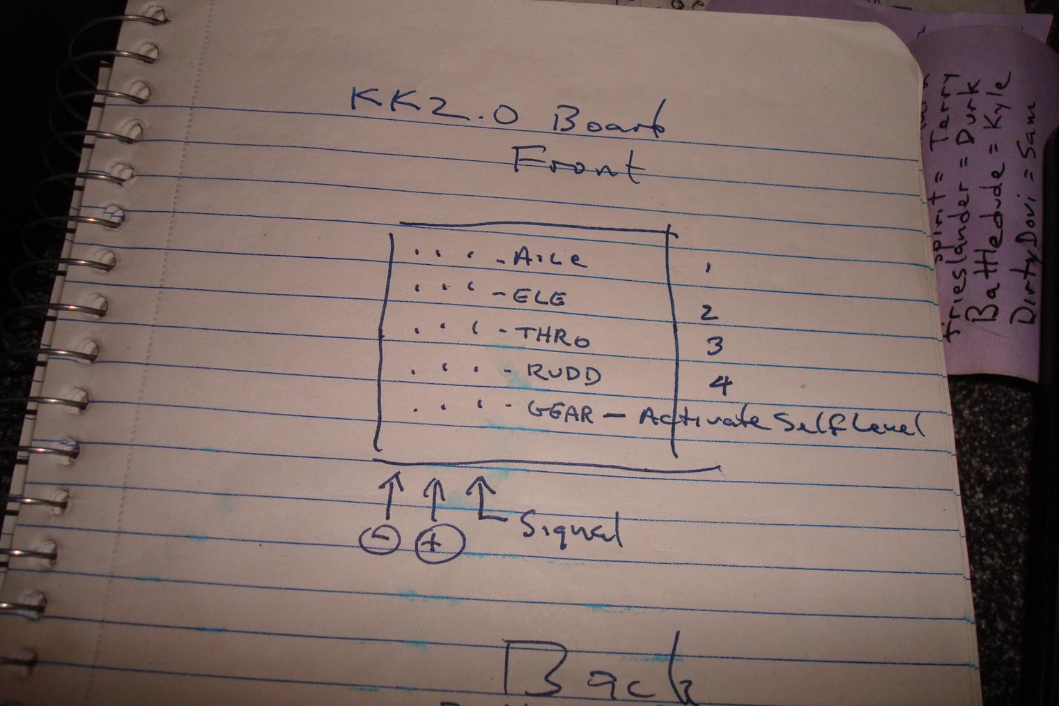

7808- Great progress now that you got your stuff. :) I do not like the looseness of those collet rings supplied with the props either. I chose the least loose, and I was careful as possible to tighten the props down centered by "feel". It shows as the props rev up if they are not close on center. This is on my "to be changed" list.
I took another picture of my Rx (which is similar to yours) and one of a note I took for the board. Channel 1- AILE, 2- ELE, 3- THRO, 4- RUDD, 5- GEAR (Activate Self Level) It may be called something else. The signal pins are closest in. The - pin is on the outside pin.
I hope this helps.

PS: The orange wire is the signal wire.

Nice work Jay. 7808 - just plug the RX in exactly as Jay describes (you will need to make sure your transmitter has the channels assigned as jay lays them out, but they already should be since it's standard) - you'll be halfway there. You may have to reverse the throttle channel (often they are full throttle when stick is down). Then you just need to connect the ESCs to the other side (motors 1-4 which will have to be matched to the X-Quad configuration) and you're golden.

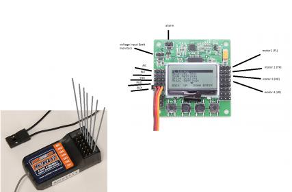

7808
that so far is the only thing ive seen that made any sense lol thank you
maybe some one can connect the lines on this picture so others will find it and it will be easy
also my tx is mode 2 throttle on left if that matters

You should make a chart. You need to chart the channels from your TX (therefore the outputs of the RX) to the channels on the KK2. Match the aileron, elevat, throttle, rudder from the RX channels to the KK2 on Jays diagram (which matches the photo I linked to).
