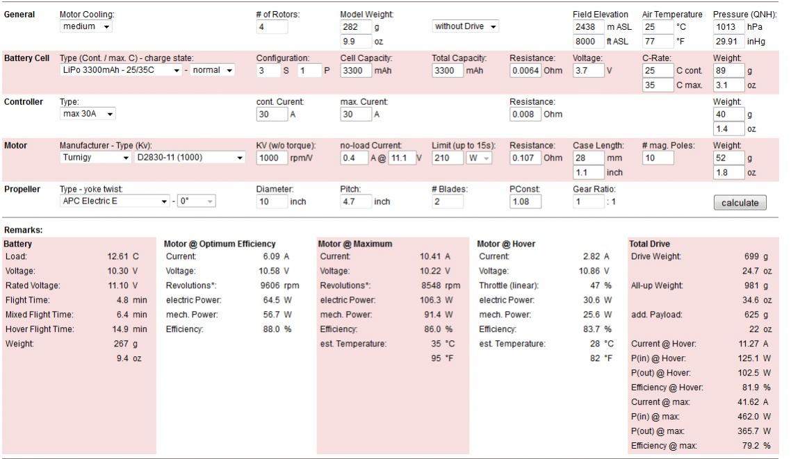

eCalc info for mine....
Thanks for the tips guys!
Scott, I had already read and re-read that FAQ....there are some other good ones out there and I understand the concepts (at least I think).....
Here is what I came up with last night and hopefully it will help the OP......NOTE: the elevation is 8000' because that is the alt that I live at so YMMV.
Still trying to figure out the answers to some of what is contained in the report but I will post that up for another thread here on the forums.
Mike :)
EDIT: I finally found the "HELP" section on the eCalc website and it explains a lot of the questions I was concerned about. It is at the top right of the page....

Mike, that air starts getting thin at 8000'. Out of curiosity I am going to throw my numbers into eCalc and use your elevation just to see the difference.

Mike- My basic setup would not even fly without changing to a larger prop (or larger) according to eCalc (or without reducing weight). Interesting stuff. One thing I can not do is print out those neat graphs and the data for "hard copy" other than my chicken scrawled notes laying all over the place.
Jay,
I simply hit "Prnt Scrn" and copy that to the paint program on the computer. Then I just size it to fit and print. Works pretty good but it would be nice if there was a print option! I too have pieces of paper laying around with miscellaneous notes scrawled all over them! Time to get organized!!!!!

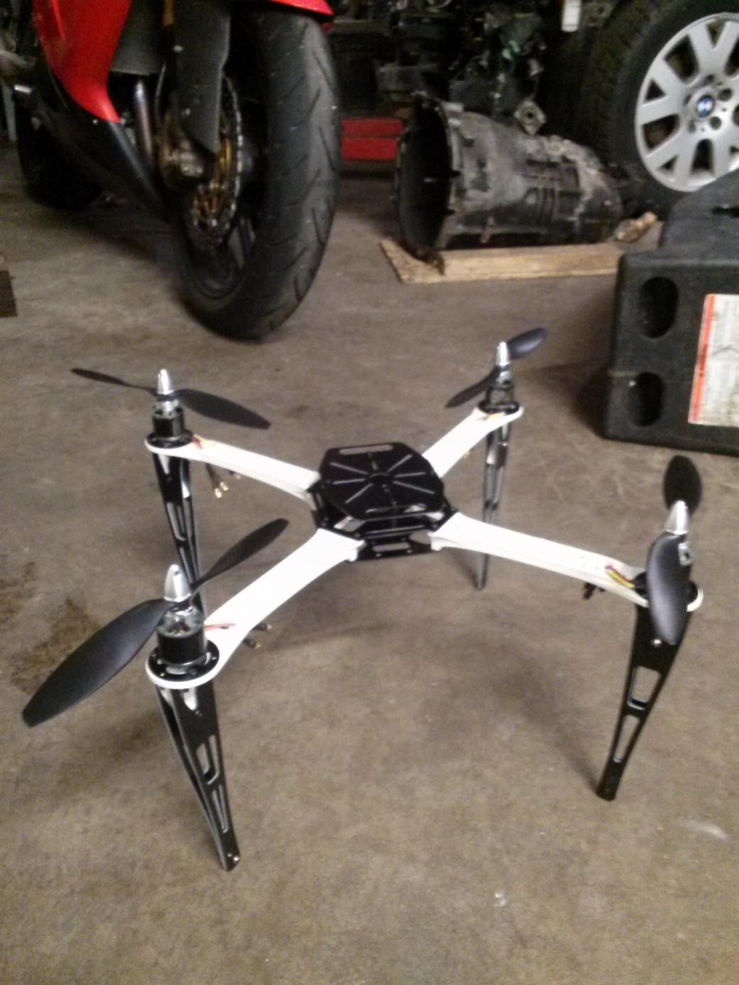

got parts the other day, still waiting on the rest. assembling everything with 1 hex key and tiny screws was not fun

That's good looking so far. Do you have a hex driver? Best investment. Way better than the L shaped old school versions.
What kind of bike is that in the background????

i picked up a little kit today with small bits and a little ratcheting driver, sucked i didnt have it yesterday night, after a few drinks it was getting aggravating
the bike is a 05 zx10r - gota keep my mind off it in the winter with other toys and projects lol
these slow fly props - do the "R" props go in the back rotors? does the markings face up or not matter?
note: the extended landing legs for the sk450 have some weight to them, they probably almost double the weight of the bare frame

THIS shows the orientation/direction of the props. The R is for right, or clockwise. The others will go CCW. The writing should be up - it is on mine. But if you take a look at the prop you'll see that it would only function 1 way.

ah thanks.
yeah i checked out your site, ive had a few old jap bikes but i didnt restore them more opposite - chopped them
i got 8 and 9" props so we will see how that goes. i just stuck the 9" ones on to see how it looked, none of the spacers that came with them seemed to easily fit to center the props on the shaft, but i didnt really spend much time trying. will update when my other parts show from malaysia

Did you get the accessory pack with the motors??? The size of the spacer will need to match the prop adapter meant to fit that motor/shaft. Should be some type of collet adapter.
