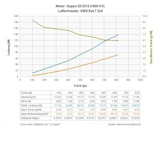

Some good balanced graupners might to the trick yeah. But that leads me to my final step in building my TBS. Other motors or not?
I'm using as mentioned a Suppo 2212/13 1000KV motor with 9" GemFan props on a 3S with RapidESC (SimonK Firmware)
Gives me this (one motor)
They give much thrust, no doubt. But would a 4S improve my FPV quad? Like getting some 900KV 2216 motors with 8" Graupners and a 4S Battery.
I don't want to buy a 9" set graupners for a 3S setup and a 8" set graupners for a 4S setup.. Waste of money in my opinion.
I've ran the suppo 2814 1000kv on 4s with 9x5 graupner props. it'll carry 6000mah of 4s and fly for 12-15 minutes depending how fast you go. on the rig above, it carries the suppo 2810 1000kv running on 4s with 8x5 graupners. That's whats in the two vids above, 2814 is the river, 2810 is the train tracks
yea, the ear plugs paint right up nice, i use it on my zII and it's the bomb. the mats not bad if you can split it with somebody, but honestly they both do the same thing, fix the final jello from whatever you end up tuning at
2212 is kinda on the small side, the 2810 are just enough and the 2814 are like flying around in a jet versus cesna. only problem is there super sensitive to altitude and that throttle, the smaller motors make it all smoother but sometimes don't have the oomph to get over stuff and stay flying forward.
i love the suppos for what they are. i use em as throwaways, crash it and tweak a prop, i'm most likely going home and swapping out the motor, prop adapter and prop just to keep it recording like that

With a 3S 2200 mAh I can fly for about 12 minutes aggressive. So actually very decent flying times. I'm using Gens Ace LiPo's since I really like their perfomance.
So 6000 mAh and only 15 minutes? :(
Doesn't look like an improvement to me. Motors are indeed small but very powerful for my rig. I don't carry a heavy GoPro.. My cam is 38 grams and shoots 1080p
But again, I guess you have an explanation for this? :D
I don't have the money to buy new motors every crash.. :p
