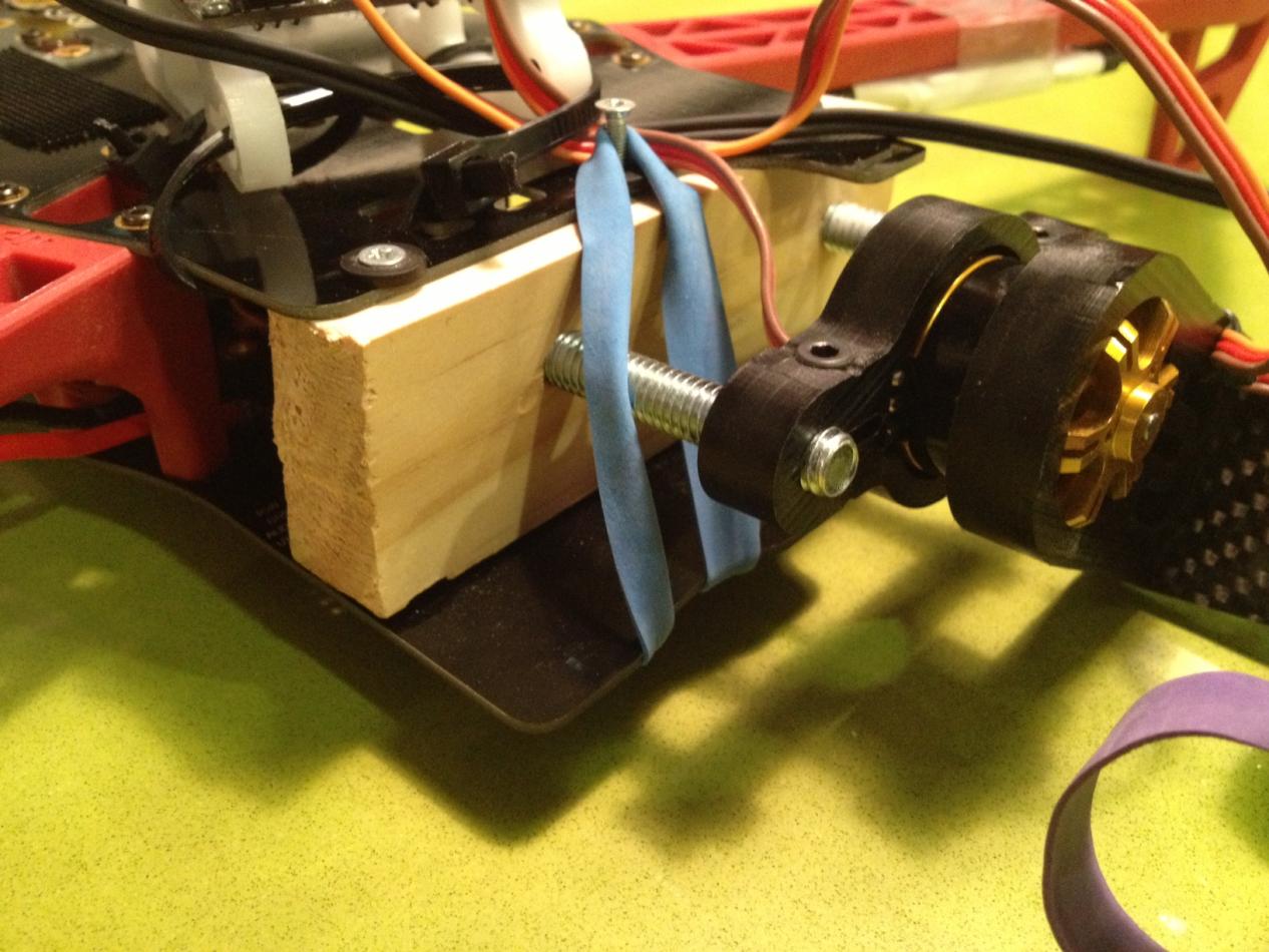

older thread here just wanted to post my 'frankenstein-ing' from this weekend, its not pretty but yielding good results so far:
tbs disco, dji motors/ESCs w/ 10" graupners. quanternium blg and is made for the hero3. my block of pine and bolts here are 26g plus the weight of the blg/hero3 put this just under 4lbs. first few test flights I'm getting damn good footage with the smallest amount of jello. have my cog pretty close though it is a little nose heavy. handles pretty well, and after about 6min motors/ESCs are warm but not blazing. prolly going to redo mount this weekend and recess the blg a little bit, just want to be able to go full wide without props in shot. so far so good!
