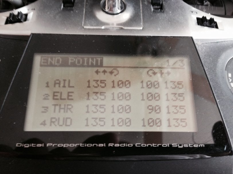

I have 2 SuperX fcs. One of them is having a software issue regarding"Configurator Version Mismatch" that I have been trying to get resolved with XAircraft for over a month. I bought both of my fcs from Drew and we all know that he is no longer around. Yesterday, I spoke at length with John Wood at Addictive RC in Tucson. He was very helpful and informative. One thing that he told me to do that I have not done the last 2 years is to set my travel (end points?) to 135, rather than 100. I have never seen any information about this before, so I was hoping that someone might be able to inform me if this is indeed advised and necessary.
Here are a few pics of my current settings. Thanks for taking a look and replying.

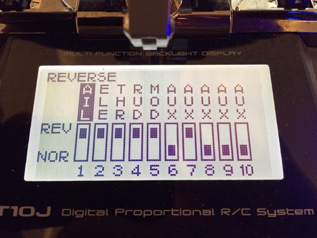

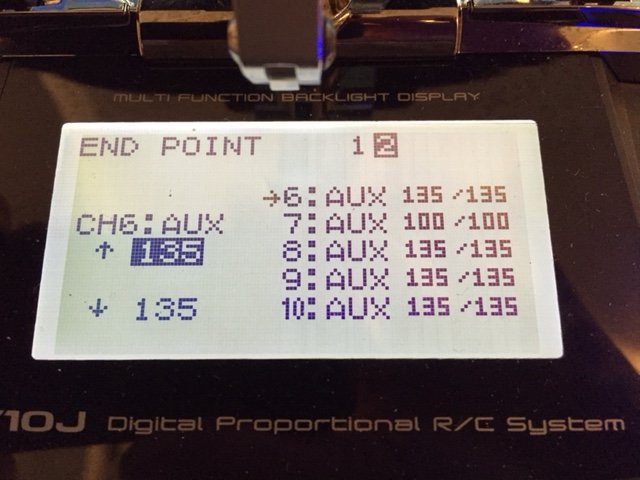

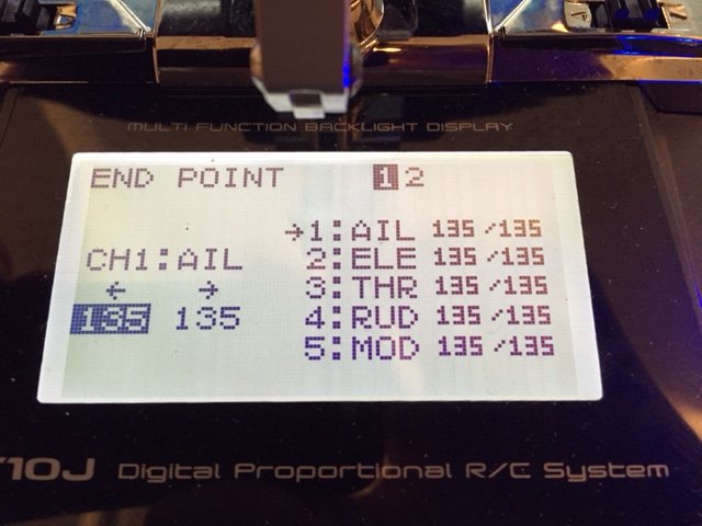

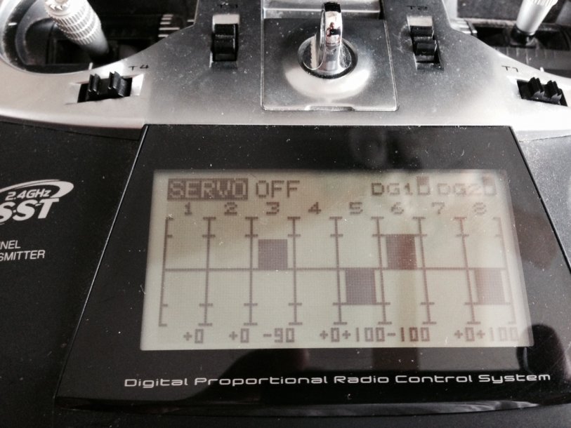

Thanks, I'm in the process of doing the throttle cali again, I'm using a Futaba F8TG. Here's a couple pics of what my settings are after your suggestion, hopefully I going in right direction.
