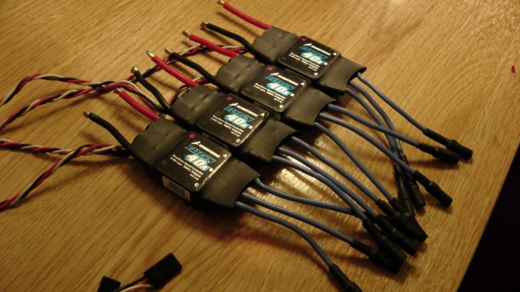

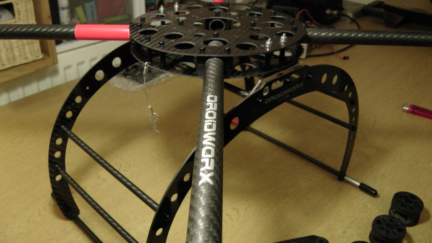

I have a brand new Droidworx VM4 frame sitting in a box under my desk, as soon as I have the time to round up all the necessary components here in the workshop the Super X will find itself a home on the VM4 frame along with a set of 2814 motors and 4 HK Blue series 30 amp ESCs reflashed with SimonK code.

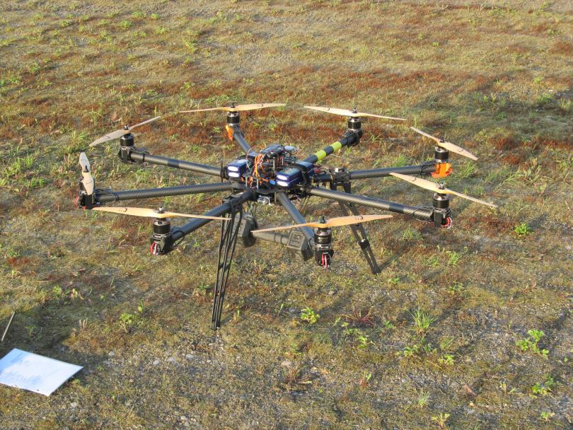

i also used a SuperX on a review for RCG for the Avroto LIFT series motors. Here's something pretty cool.
I tuned the SuperX with NO payload on this HEX, and then we added 9 lbs of payload and I did not have to change the tuning! Check it out:
