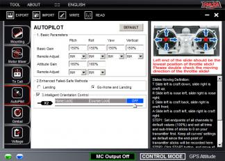

I don't believe this jerking is a gain problem, which I have set 150% on the 4 main axis, and I have atti gain set to 160% ?

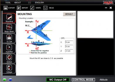

In your GPS settings, the red area is a positive number and the green is negative.
If your GPS antenna is lets say center to your craft, you would enter something like this..
X = 0
Y = 0
z = -5 or the height to the top of the GPS from the CG.

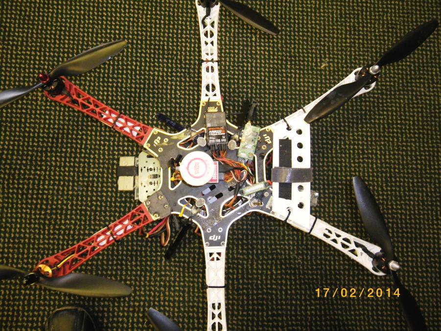

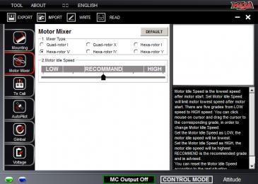

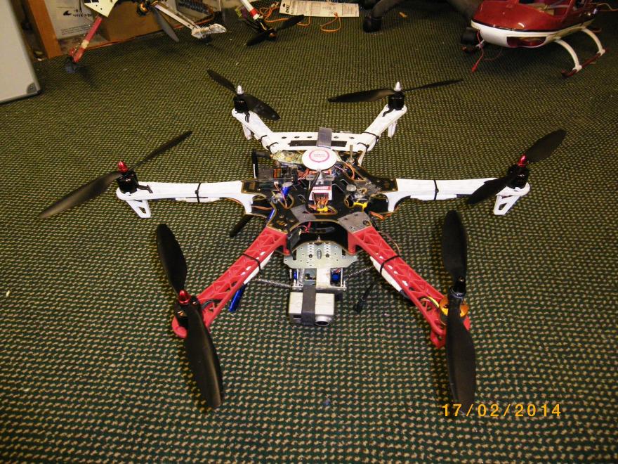

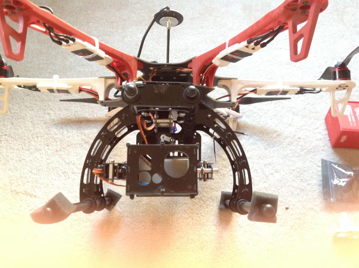

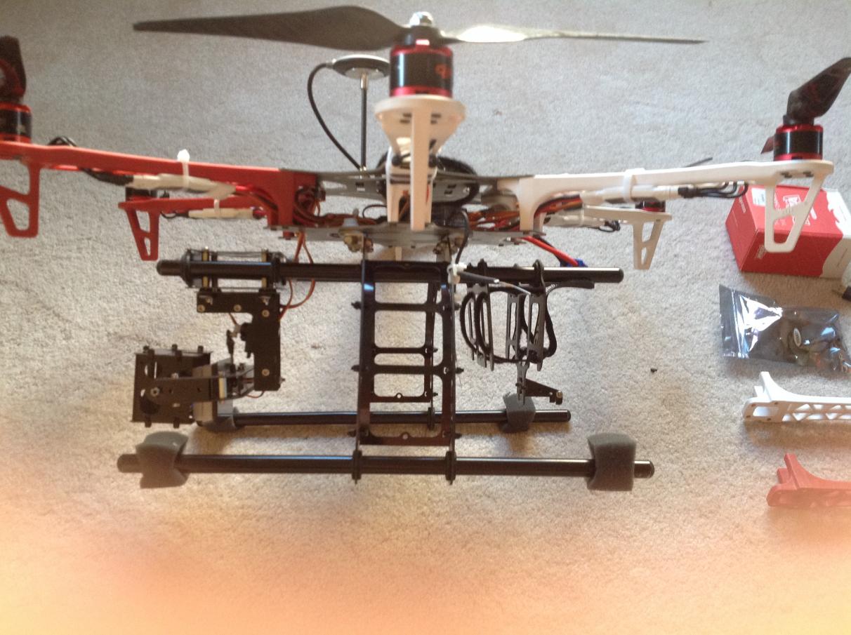

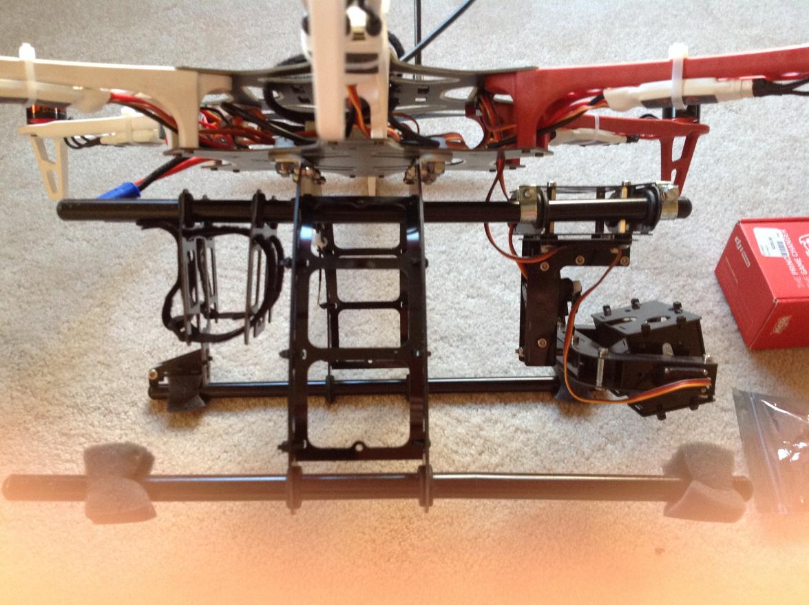

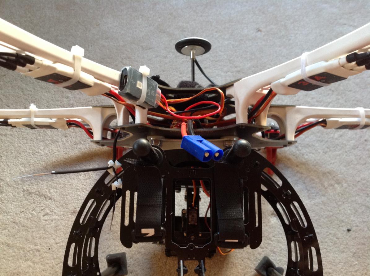

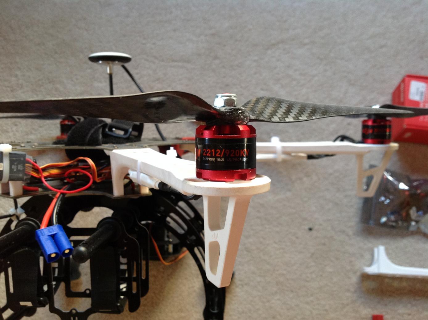

See if this helps you, you may also have gain issues, please post your gains and pictures of your F550 if possible.

Tahoe Ed

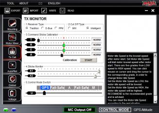

Your GPS is not at 0 on the X axis. Your aileron is not centered green. My guess is that you COG is lower than the top plate. Hang this from a motor with the lipos and camera attached. I would check your settings, recalibrate your Tx and do the advanced calibration on your IMU and then calibrate the compass when you get to your flying field.

I am a little confused as to how to get the aileron centered ? I have them set at +/- 100% and cannot use sub trims or normal trims, or it will not initialize, I get constant flickering yellow of the MU when I do this. How can I center an axis that does not center automatically when I click "finish" ?
I also noticed that I had to fly with right aileron applied all the time in the 2 recent test flights, no doubt due to that failure to be centered ?
I will certainly double check my COG calculation, but it ain't that easy to get it right on the Z axis accurately.

Have changed GPS settings to -4, 0 -6, which must be pretty close. I sure didn't see that it was actually forward of the true COG, so thanks for that.
