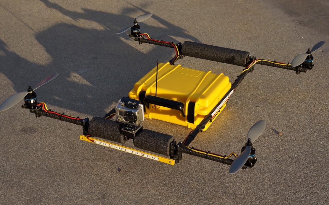

I have found in my own waterproof prototypes that increasing the size of the esc's does help reduce the temperatures when they are enclosed in a sealed spaced.
Ditto... Vastly overrate ESCs in a sealed environment...

That said, I have done builds where the ESC was entirely within an enclosed body or dome, the way I dealt with the cooling issue was to remove the shrink wrap and use some Arctic Silver thermal epoxy to attach heatsinks to the FETS then recover with shrinkwrap after which I cut away the area covering the heatsink. In the four multis I currently have setup that way the ESCs stay well within operating temps even under heavy use in 90 plus degrees ambient temperatures. They do get hot but not nearly as much as if they had no heatsink and remained wrapped in plastic.

Thermal dissipation and cooling are important too. Overrating the ESC can eliminate the need for active cooling (in prop wash). Sealed environments are possible to engineer but require thoughtful thermal practices.
