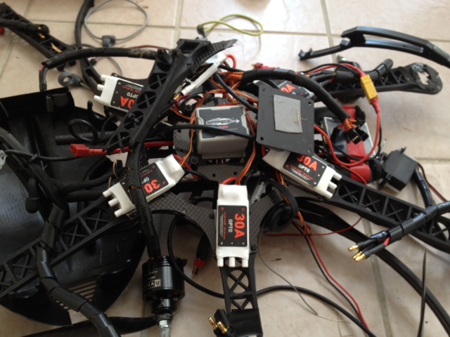

Hexa down:
My Hexa crashed today. It wasn't due to power failure, or WKM issue. It was my brand new Gemfan carbon fiber props. One of the props snapped while in flight leaving my craft a wreck. After an hour of trekking through the woods I found my craft in pieces. Power was still applied, even though the battery was puffed and smoking hot. The Nylock did their job and didn't come off. The carbon fiber prop snapped in mid flight bringing the craft down.
I should have stuck with my APC props....

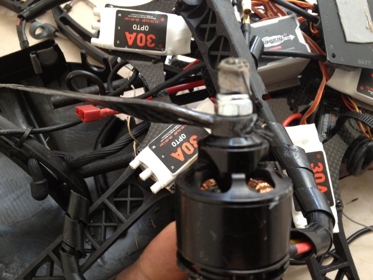

Nylock works, carbon blade failed.
View attachment 4972View attachment 4971View attachment 4970View attachment 4973View attachment 4974
ouch, Dewster, are these the "carbon reinforced" Gemfans? I just received a set, and after reaming one prop to the right size for the DJI motors, it looked waaay too thin at the hub... Sorry for your craft, but so glad I threw my gemfans in the drawer...
I think I'l spring for some Graupners....
These were the full carbon blades. And you are right...they are not strong enough at the hub. While flying (very conservatively since this is my photo ship), I heard a loud snap and then watched my flat hexa spiral out of control onto the ground. Needless to say...the Nylocks did their job well. All of the hubs were still attached. It was the blades themselves that failed.
I don't see the point in having carbon filled nylon blades. That almost says: yeah...we can't do full carbon so we'll make a hybrid. The APCs flex. The ones I took off of my Hexa were still good. They needed to be balanced, but their integrity was good.
Here are some photos of the Nylocks doing their job. You can also see where the blade failed:

BerndM
Hey Dewster
Very sad about your crash. It REALLY sucks that you went to the effort to get good strong props and this happens.
I, and I'm positive, all the other lurkers here would really be interested in the response from the dealer you bought the props from.
You ARE going to be contacting them, right??
Will they stand up and help repair the heli ???????
After all, the carbon props are SUPPOSED to be virtually indestructable.
Please let us know what the outcome will be.
jes1111
To my mind there are no surprises here. The APC props are made of nylon - a fantastically tough polymer. "Carbon-filled" anything must use a more "rigid" resin (of one sort or another) to have any chance of seeing the benefit of the carbon fill - and that very rigidity means its going to be subject to stress fractures. Short of using high-tech composite sandwich construction (à la full-size helicopter blades), the best all round material (IMHO) for a prop is the original one: wood. :) Have we seen any reports of Xoar/JXF props spontaneously self-destructing?
tstrike
pendejo grande
Dewster, sorry about your crash, it doesn't look like you have a washer under your locknut to distribute the compression. Also whatever that gewber is above the locknut is probably throwing your motor balance off and is unnecessary since the whole point of a locknut is to "lock".
Ed, those star washers get compressed easily and after only a couple times of compression/decompression they become thinner and need to be replaced. If dji would add just a couple more mm's of thread on their prop shafts a graupner wouldn't need any gimmicks to work on a stock motor.
8mm bolts only need 16-18lbs of torque and that's not as much as one would think.
