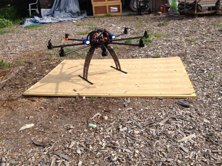

the kit came in Saturday night and i had to work sunday, but i seen some spy photos and was like does he sleep?
yes, it's got a temporary set on now waiting for a real power set to come. AMP maytech 65 and AMP 500 motors......
it's completely setup long range fpv, it'd be more likely to carry 20-30 amp hours of packs than reds, but none the less, i'd fly anything it can lift safely.
on it's maiden i did....... It's got a set of 12x6 graupners, were doing a demo 2 man filming surfers for trans world and spy optics with a nex on saturday.... Gonna build a couple smaller 2 man brushless gimble rigs to target that market
The new motors come in next week with them tiger cf props, 15"
