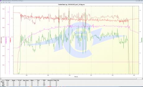

If any of you guys like diagrams then you may enjoy this. It is a screendump from the Castle Creations Phoenix ICE 50 Lite data log.
From the last part of the payload video.
By the way, AXI 2814/22 is a 14 pole motor - correct? (the pole count is a necessary input to the data log software to calculate correct rpm)
And yes, I know the motors are rated at max 25 amps for 20 seconds.:shame: The peak current occurs only when flying in manual mode and slamming full throttle. Which I did just for test purpose.
/ Tomas
Edit: For full image resolution, download image from here:
https://dl.dropbox.com/u/36968875/CCPhoenixICE50Light_screendump.PNG
