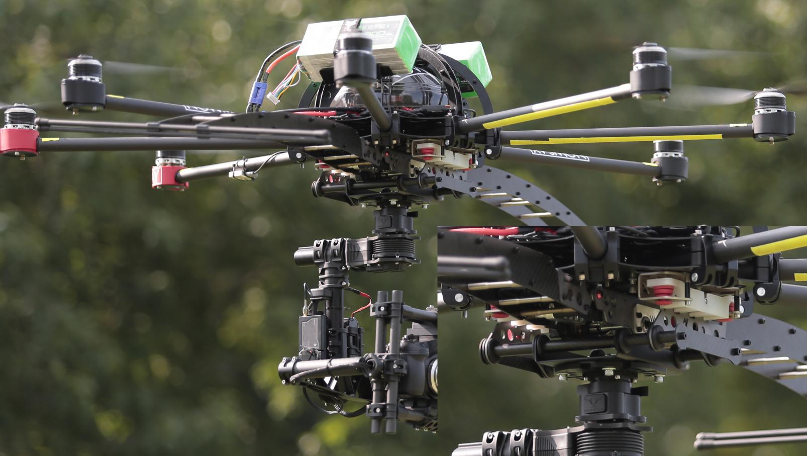

on 20 amp hours of p6s it does 12 minutes hovering, 9 minutes of booking around chasing stuff
the black dampers are the similar durometer as the yellow, they just don't flex around and let the cam shake as much....... we were addicted to teh red ones for everything because of such and my crazy flying style, but the black settled in and aint going anywhere
this was one of the last flights on the yellows,,,, can see it shake pretty good
my little 800 with all the same stuff....
Quinton
Those railway shots looked really good, but yes you can see the bouncing about.
That first video, was that a GH3 on there, and did you have a follow focus attached, or was that the auto focus kicking in at 3 min 4 secs?
that would be a question for jcmonty..... i just tune and fly the top part..... it is a gh3, about the extent of me understanding cameras. he uses alot of some kind of auto focus cause in low light that thing bounces around and ruins a shot from time to time, alot less in the bright light
the yellows are crap, we had nothing but problems, as soon as we went to the black all that stopped. the red work good if you can balance a prop perfectly, otherwise you'll get jello. We love the ol jib, shes a beast and so easy to fly a caveman could do it
black dampers and the gh3 i believe
raw av200 and gh3 on yellows

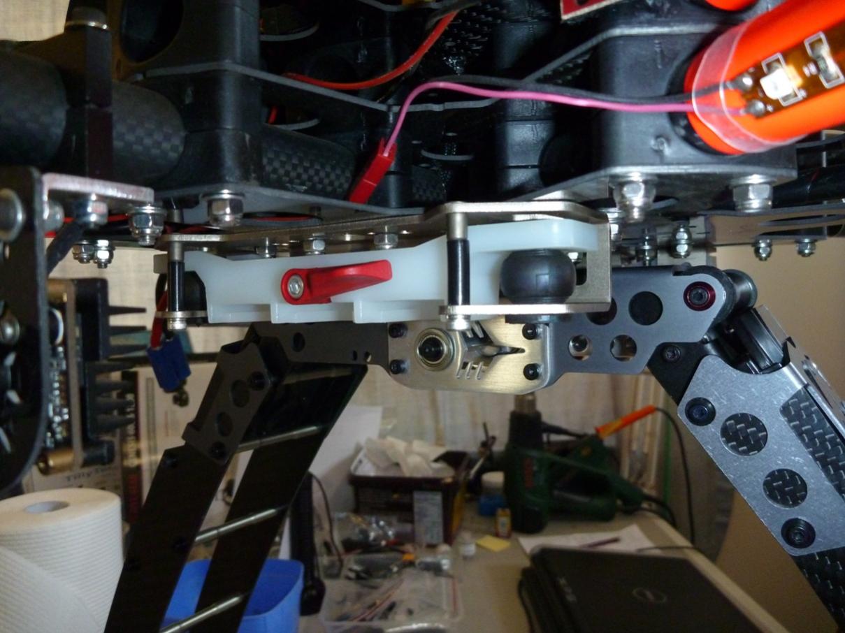

Issues with skyjib gear rail grommets with movi
We were very confused by the instructions on build day too. Finally got it figured out we thought but the thing is moving all around on these rubber grommets. We have tried both black and red that it came with. Since the picture we have also tried flipping the grommets upside down (more like the pics show in the build manual). Anyone else having issues or know the fix?

Aeronavics released a set of new dampers made by Allsteady which stop the side to side and wobbling gimbal movement. I've been running them for a couple of weeks and are a huge improvement over the original ones which were flawed by design. There are 2 different hardness.....Hard and very hard, I'm running the hard on the copter and very hard on the steadycam.
Part numbers are
Hard 1406-0324
Very Hard 1406-0235
Regards,
Lance
