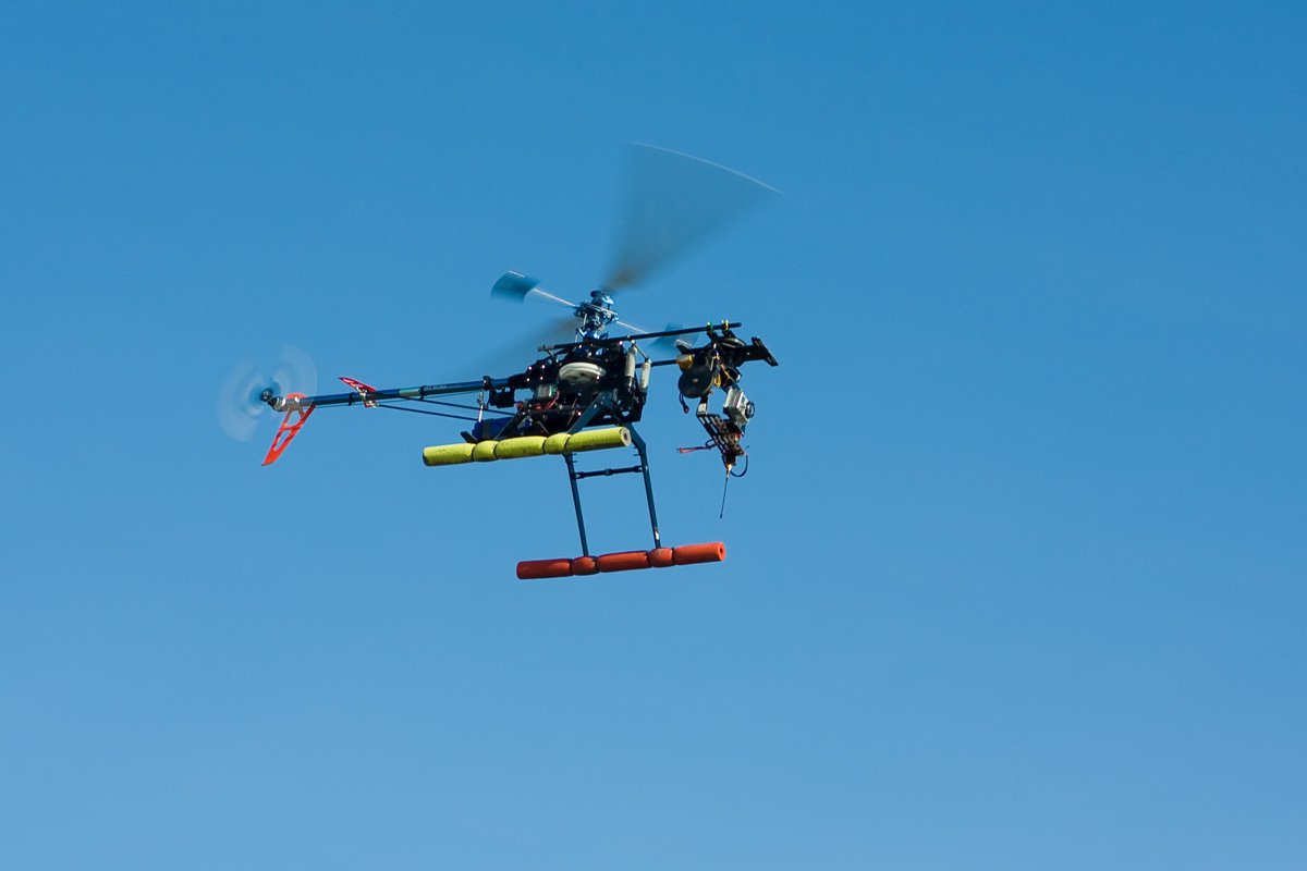

Big weekend for me with the SRH. I've got it mechanically working well (still with straight cut gears). Then, I finally got it to position hold. I'm the first to get this nailed.
Here's the video, but first a quick explanation. At first you see me flying it hard, I'm just testing the stabilization first, make sure it's good (it is, I was wanging the sticks around). You can see the roll looks good, but the pitch has that nasty bob going on. That's actually just a stupid mistake I made, the SRH needs different gains on roll and pitch due to the different moment of inertia on the axes, and I knew this but accidentally had them equal. So just ignore the bob. Then I fly up, go into Loiter for a second (you can hear Mission Planner talking), then back to stab because I wanted to move it over a bit more, then back to Loiter. Basically the rest of the flight is on autopilot position hold until I come in to land. The heli held almost perfect position, the movement you see is actually the altitude going up and down due to the poor barometer performance on the 1st generation Ardupilot board which this one has.

Congrats, looks great, whats the head speed start at there, 1500? no governor? that helps alot usually, keeps everything speed wise up top and out back the same so it doesn't want to change thrust. So can you send that thing off to do waypoints, set down the tx and ride along?

Actually, I'm not entirely sure what the headspeed is. I want it at 1800, but the governor sort of sucks.
Yes, theoretically it can do missions, but nobody has done it with the heli yet. I'm sort of leading the testing and development of it at this point.

This is the HK600GT. So it's pretty junky, but I finally got it working. I'm building up a better machine slowly.
I'm pretty sure I could fix the video vibes, this camera is literally hard mounted, and I don't find the jello is too bad compared to many other things I've seen. I was worried it would be just a blur.

No way they are made in the same factory. Most of the HK600GT parts are actually cast aluminum, and then they finish machine only the functional surfaces. The aluminum is therefore a very soft cast aluminum grade, and tolerances are hit or miss.
The Align parts are machined from 6061 or 7075 billet and are much stronger, and much tighter tolerances.
But if you are so inclined, try the HK550GT. I think it's made by a different supplier than the 600. My HK450Pro FBL is virtually indistinguishable from Align, and I expect the 550 is too since it's also a new kit.

Any gimbal will do.....here's an underslung gimbal mounted to the front of our 600:-
Moved the 6S lipo to the rear as a counter balance...very easy to do as well.
