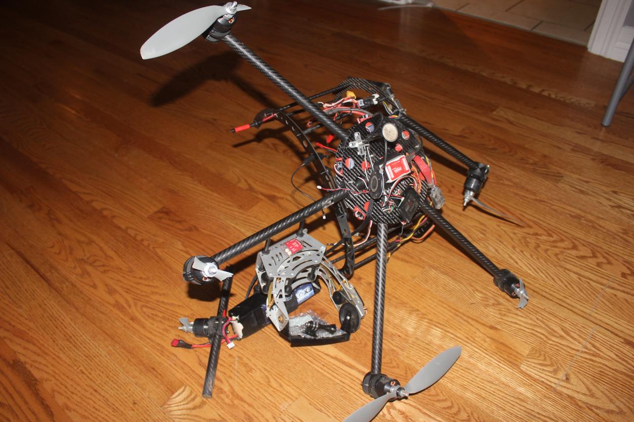

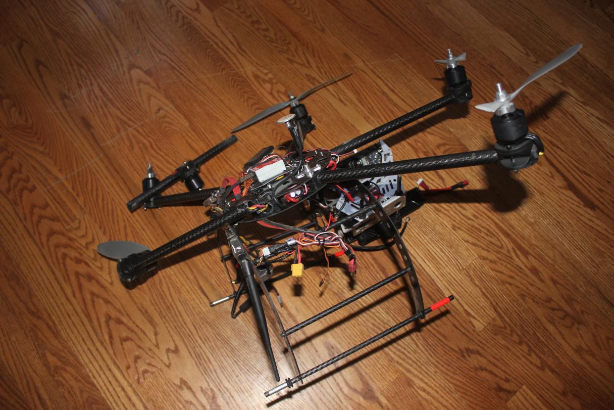

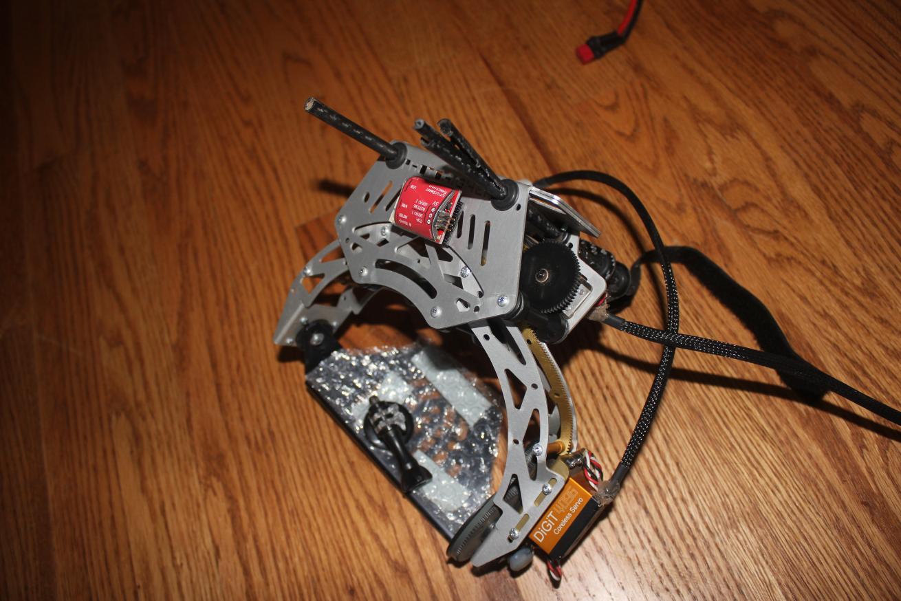

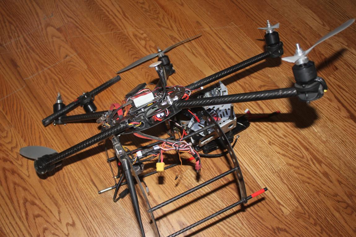

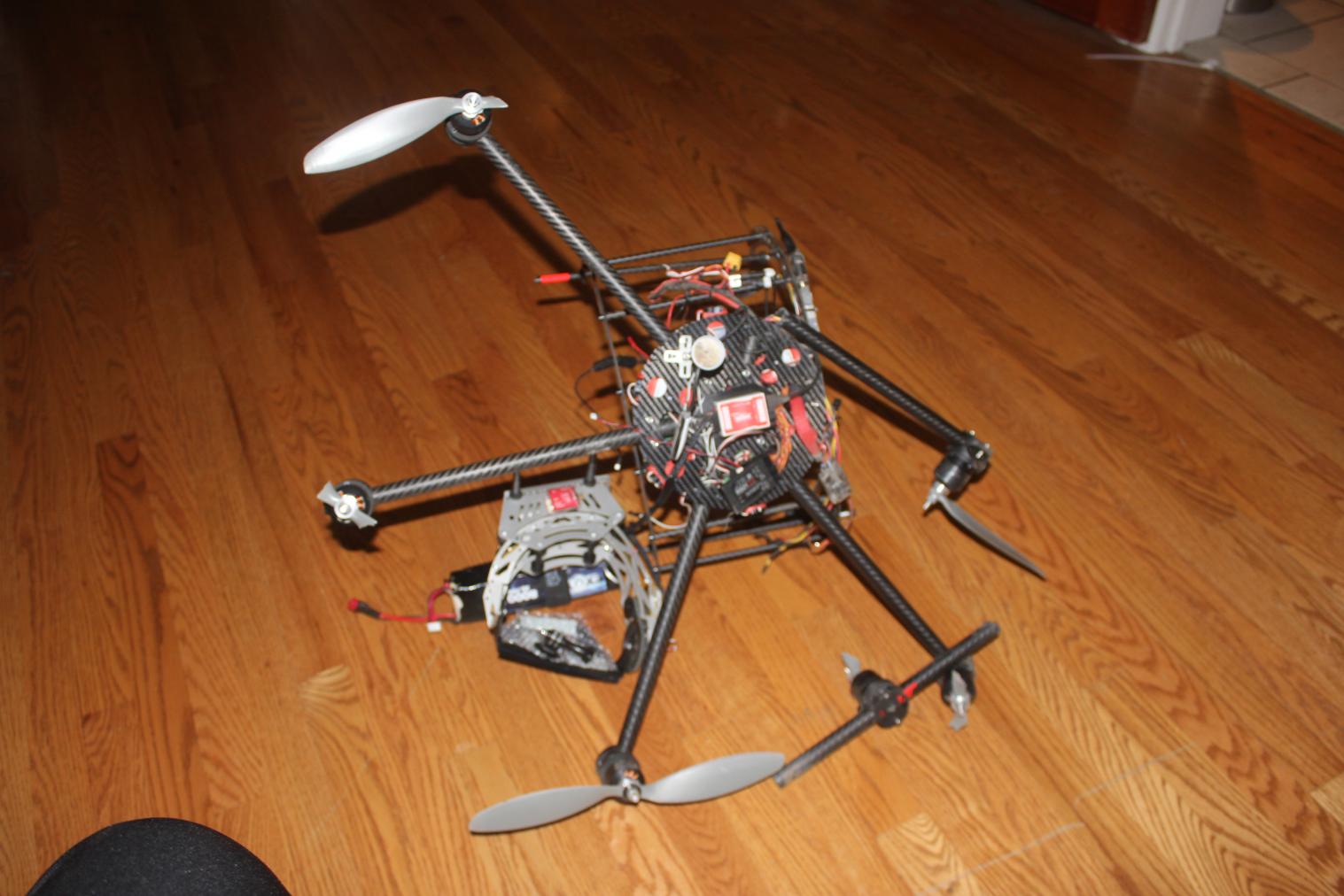

I have logged 63 amazing flights with my AD6, AXI, AV130, NAZA GPS ship that I love. On flight 64 - boom. I have been working really hard to get my video skills up to snuff. My dream is to chase my kids around skiing and snow mobiling. That is the reason I started down this path. With that said, and here is where we can learn - this morning I re-calibrated the FC. I then proceeded to get all excited about capturing some video and trying an editing trick I had just discovered in CS6. My brain was already on the CS6 trick and not on the flight at hand. I should have done a test flight post re-calibration - something simple. I did not. I went right to trying to film the fast moving dynamic shot I had in my head.
What did I learn - any change with the copter needs to be methodically tested. I knew this, but let myself get to excited about capturing the shot. I got ahead of myself. DONT DO THAT!
Flight went like this - lifted off GPS mode, did a low run towards a tree, went to full throttle momentarily to get above tree and tilted gimble, THEN THE PROBLEM, it seemed like 1 or 2 motors stayed full throttle (looking back, that didnt register at the time) - I thought I had some GPS issue and quickly went to ATTI - momentarily seemed like I gained control, but off it went again, this time like I had right stick slammed full left - went back to GPS and hit RTH but it was too late - and kaboom. All of that happened pretty quick as anyone reading this might imagine.
Bright spots - I was flying in a safe place and no one got hurt and I didnt damage anything but the MR. Now that the tears have subsided a bit - I am ok with what I did to try and save the ship. I am sort of pleased my instincts acted as fast as they did. I at least recognized what was about to happen and tried something. Also, this ship normally carries a Canon - today GoPro - in anticipation of my hero3 black arriving this week. FYI card was out of Hero2 when I found it. Video that was being recorded wasnt there upon first look. Im sure its there somewhere but at this point, I am washing my hands of the whole incident and moving forward. Putting full blame on myself for not doing a simple test flight post- re-callibration.
Bottom line though - should have had a nice simple flight that tested the re-callobration and not concentrated on improving my video skills. Maybe the re-callibration had nothing todo with my crash, however, it was totally my fault to not do a test flight and make sure things were up to snuff. Hope that makes sense and helps somebody - another ship - maybe :)

ok guys so here is another humbling post in hopes to perhaps save someone the troubles i caused myself. again - I take full blame, all my fault - no sympathy needed. Opportunity to learn and make me a safer rc pilot though.
in addition to my mistake, that i quickly was able to admit too... not doing a proper test flight post re-calibration and going right to flying for video and not concentrating on recent change to copter. I had to also discover what it was about how i re-calibrated that was wrong in the first place. well here is the mistake that led to my second mistake of not doing a test flight.

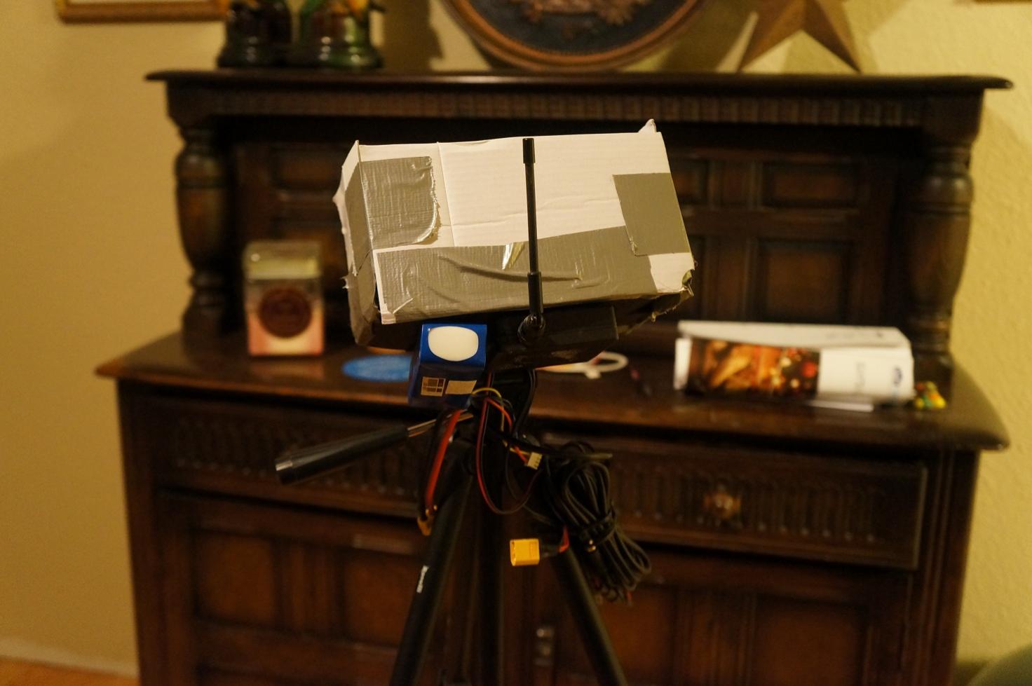

my dumbass re-calibrated my naza gps about two feet from an imac and a pc. i know, i know - total rookie mistake but in retrospect that is what i am. a total rookie. post this MR crash though, i am going to choose to consider myself a bit more educated (and a bit lighter in the wallet)
again sharing so that it will hopefully help someone. i dont know what i was thinking, i do know i wasnt really thinking and i was going too fast. slow and methodical wins this race. fast and too confident - well it cost big bucks. there is so much to this MR stuff. i think i have gone about it fairly conservatively and yet this happened. the ad6 was my 4th MR after lots of plane and heli experience. i feel for those guys with no rc experience at all, then see a red flying and next you know they are dropping some coin on a red capable ship. again - so much to it! moving on a bit smarter and safer :)
