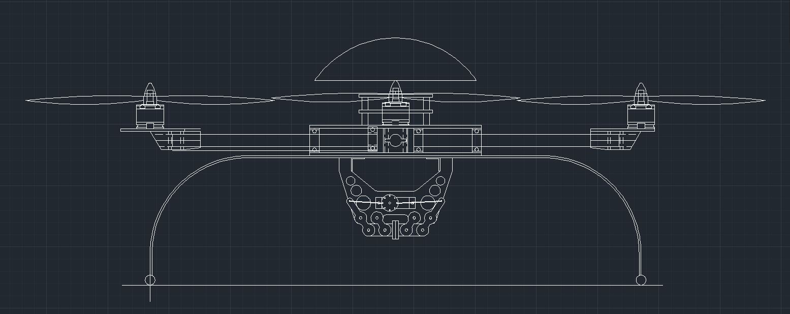

I just bought a servo for my first add on. I'm going to add a gripper to the bottom for picking up and dropping things. Water balloons come to mind along with Christmas Lights. The Lights thing has piqued my interest..It may save me some time this November... One of my other hobbies is this....

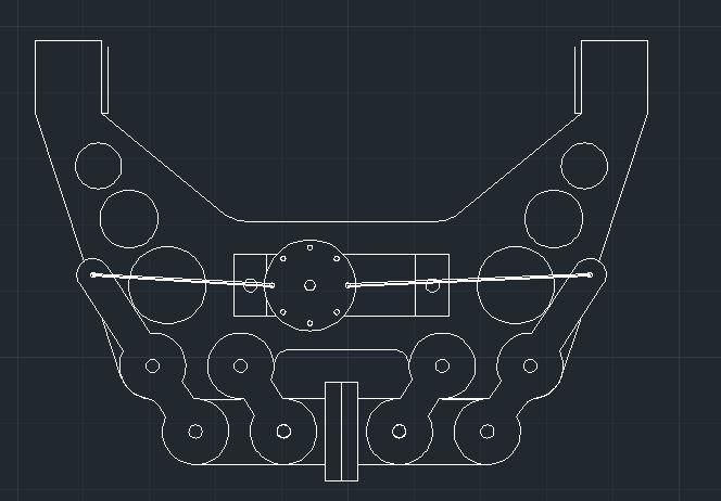

Here's what i came up with for a gripper design. I'm going to use the carbon fiber 3/32 ply laminate I used for my main plates. It'll be nice an light and more than strong enough!
SoCal Blur
That's pretty cool. One servo in the center to control the gripping action. How much force do you think it will have - i.e., will it be usable force?

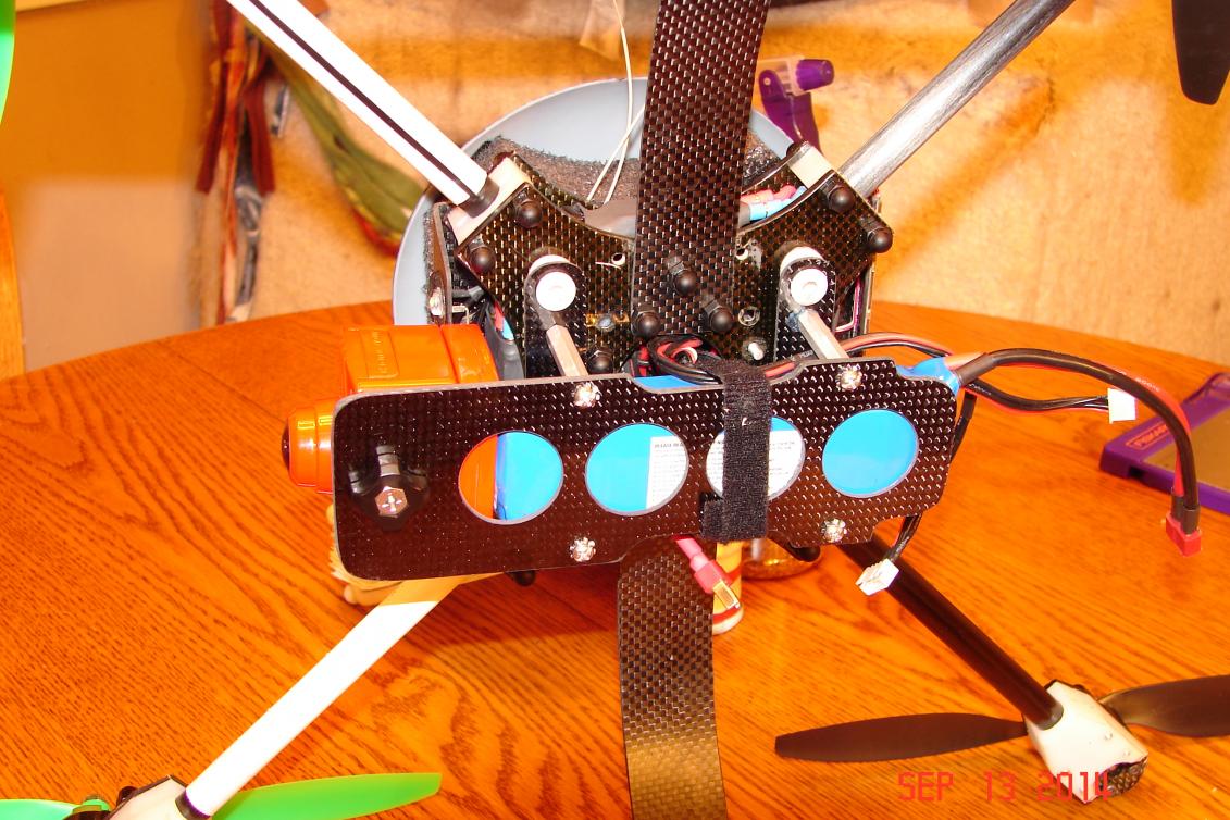

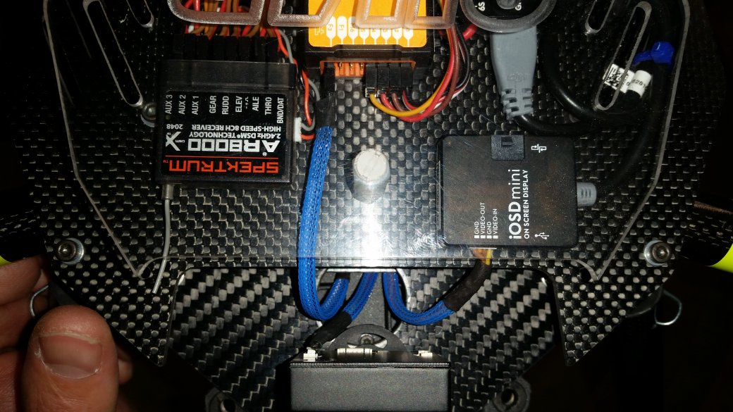

Had a bad crash the other day caused by the lack of loctite on a motor. Ouch...75' tumble to the ground. Motorwires sheared flush with the can, receiver circuit board cracked and 4 props toast. So I decided on a complete tear down and check and re-locktite. Part way throug disassembly I thought this would be a good time for a camera mount :)LOL So I designed it, made a carbon plate, cut it out, sanded it and installed it on the bottom of the quad. Now instead of the battery just being strapped to the bottom with Velcro, it has good support. The battery and camera are mounted with Zenmuse ball vibration dampers. They work pretty good and are plenty strong enough to support the carbon plate, battery, and camera. The camera I'm using is a cheap Go pro wannabe, its a Nabi Square HD. It was on sale a little over a month ago on Woot for $49. I couldn't pass it up. I've done some playing with it underwater, on the dunebuggy, as well as the ice bucket challenge (bucket cam). The camera is holding up great so far, and it's simple to use.
Here is a picture of the mount.
This is a quick video I took of the maiden flight after rebuild and the camera/battery mount getting added. The extra weight didn't seem to effect the flight characteristics at all.
