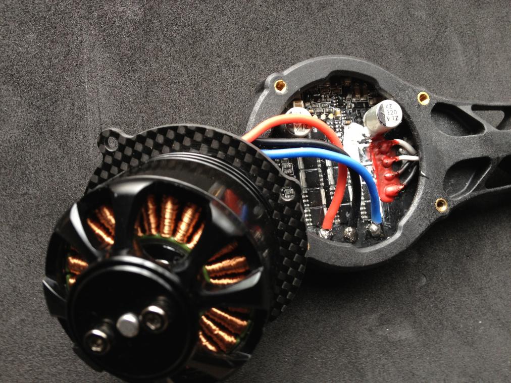

I had something like this happen before on fast descending, only it was right yaw and went in a full spin. I can't say what caused it, but I am thinking it has to do with vibration. at first it sounded like you might have mixed up some arms or props but if you switched them around then its got to be a wkm thing rather then a physical issue.
rsun
We did also have funny things when flying with the s800. We sold it and got another frame.
My friend did also have the problems and we did talk about what to do.
We made a test hexa frame in aluminium and the only thing we removed were the arms on the s800.
The V s800alu have never been better. The first time we have been trusting the s800 and it were the arms and the vibs that did give us the problems.
