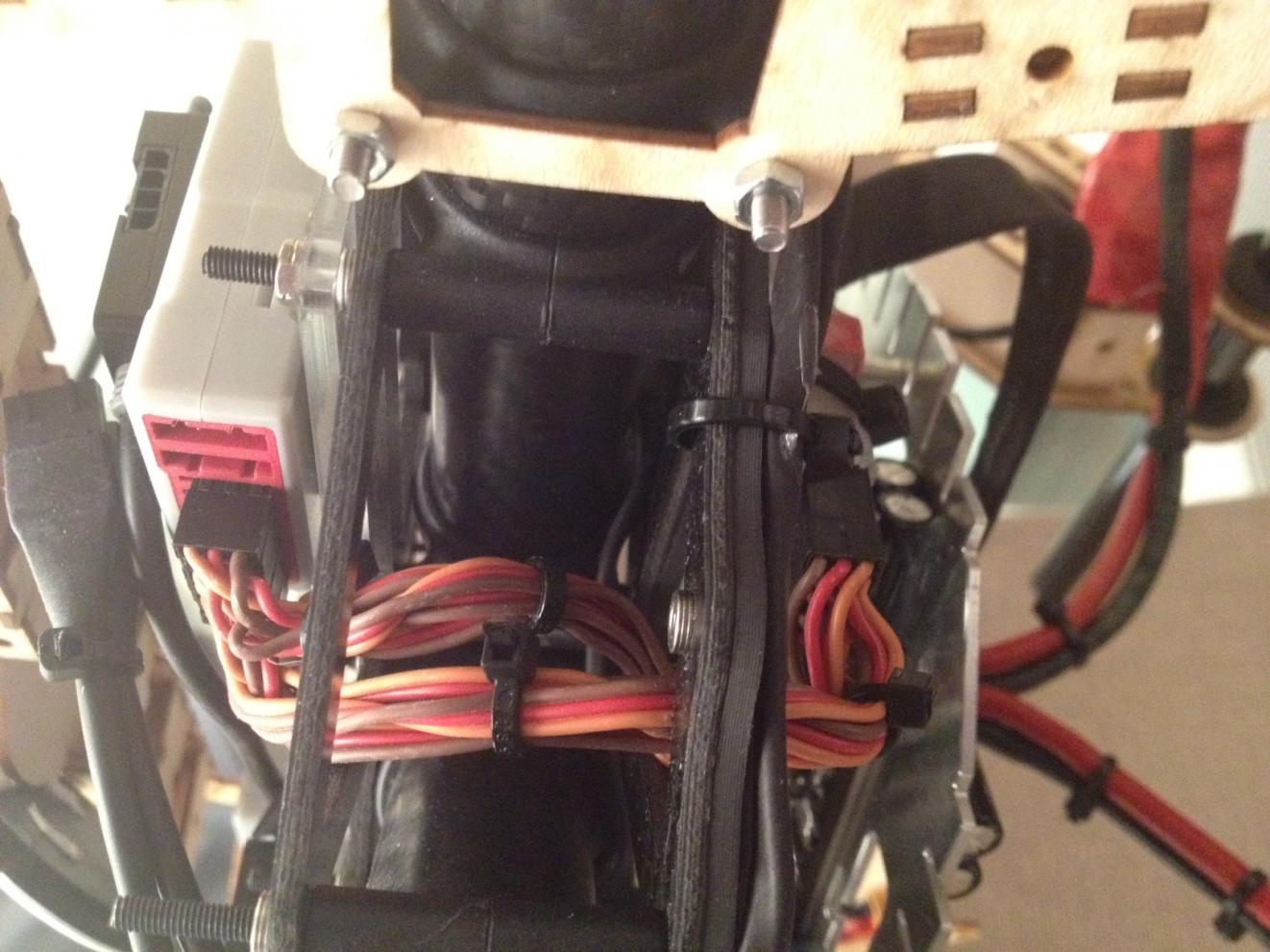

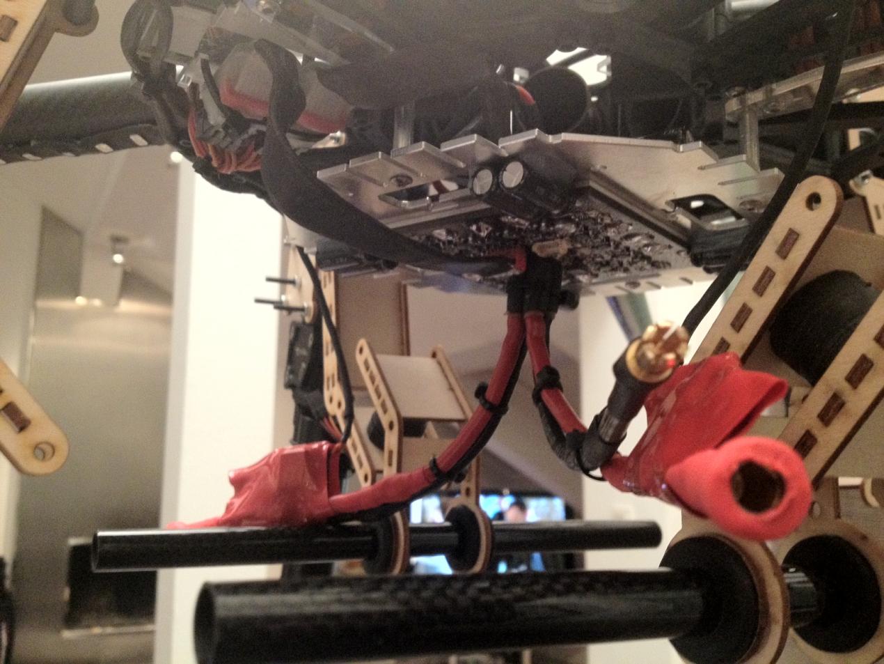

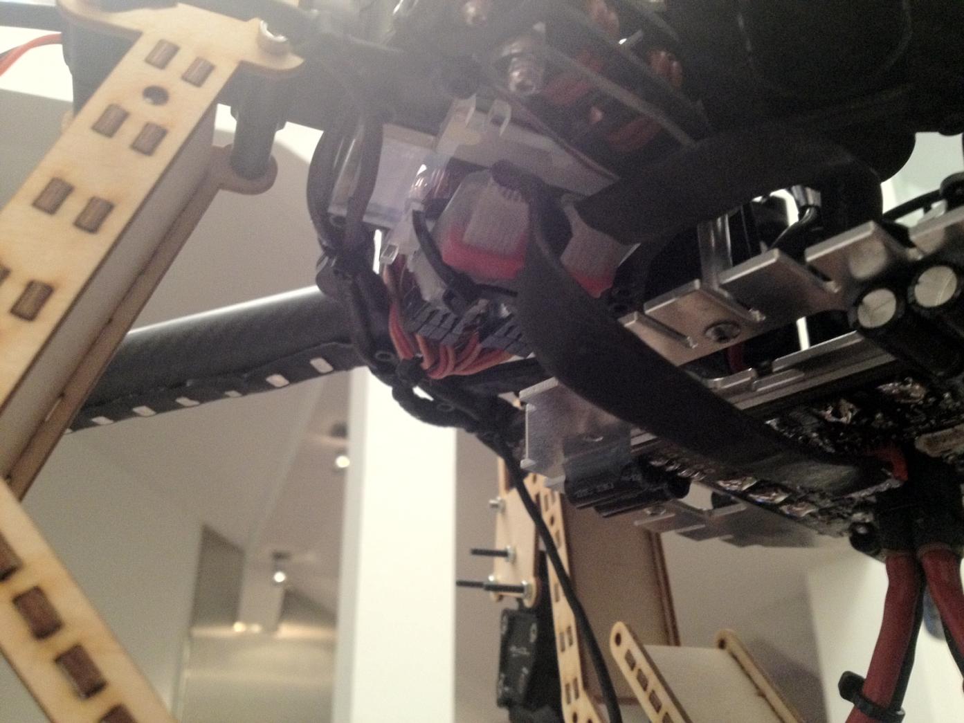

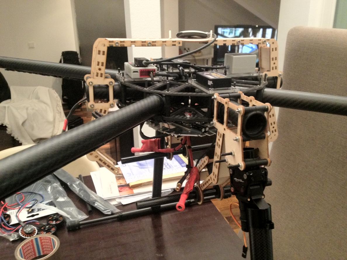

View attachment 8965View attachment 8966
Redoing completely my setup, but i made the decision to mount them under the center plate to be close to the lipos, safe and mount the vibrations mounts just for them.
Adapters and than to the FC in this case WKM.
View attachment 8967View attachment 8968
