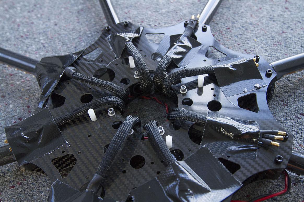

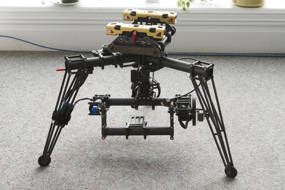

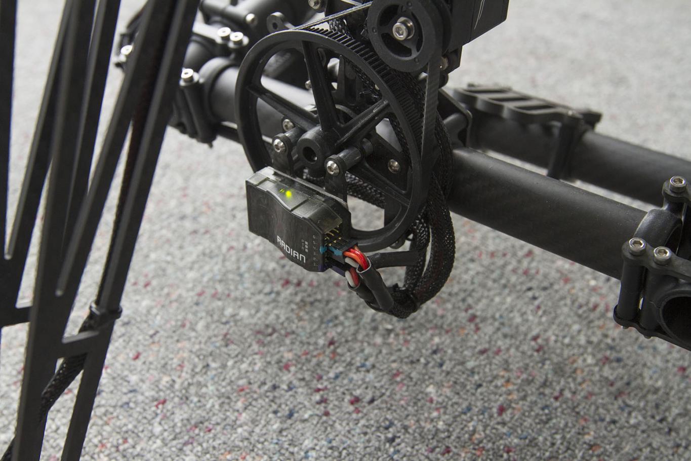

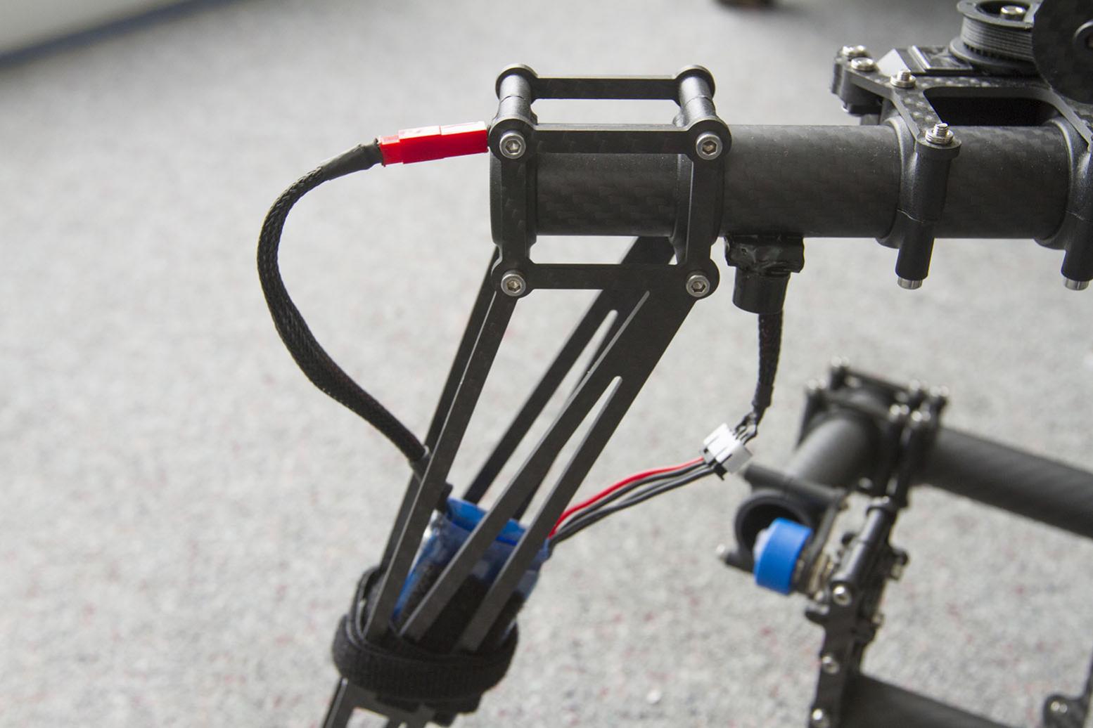

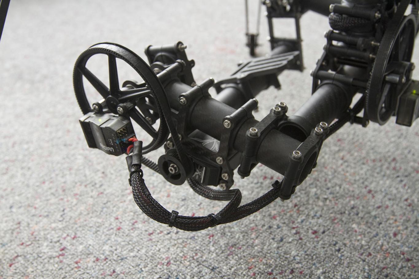

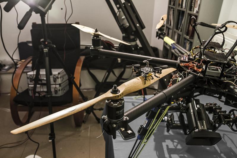

I spent the last week working slowly on the wiring of the Freefly gimbal. Trying to work out the best root for all the cables. Ive managed to get it looking good, but I forgot to add in a common mode powerfilter to the Iftron transmitter power supply. In the morning Il pull the cables back out of the booms and solder that in place.
Heres what its looking like now:
View attachment 7985View attachment 7986View attachment 7987View attachment 7988

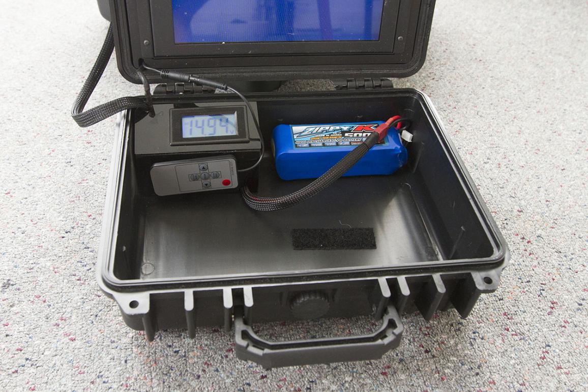

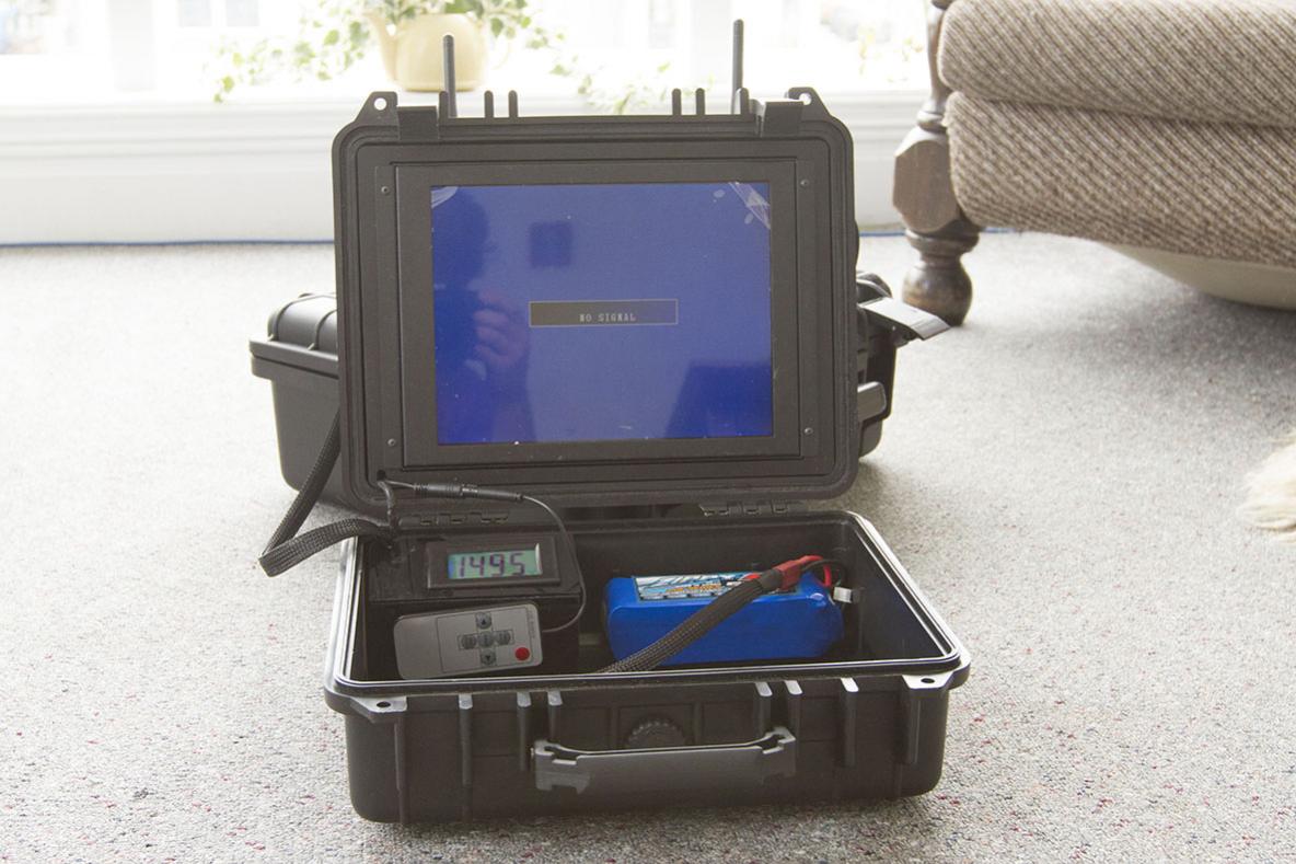

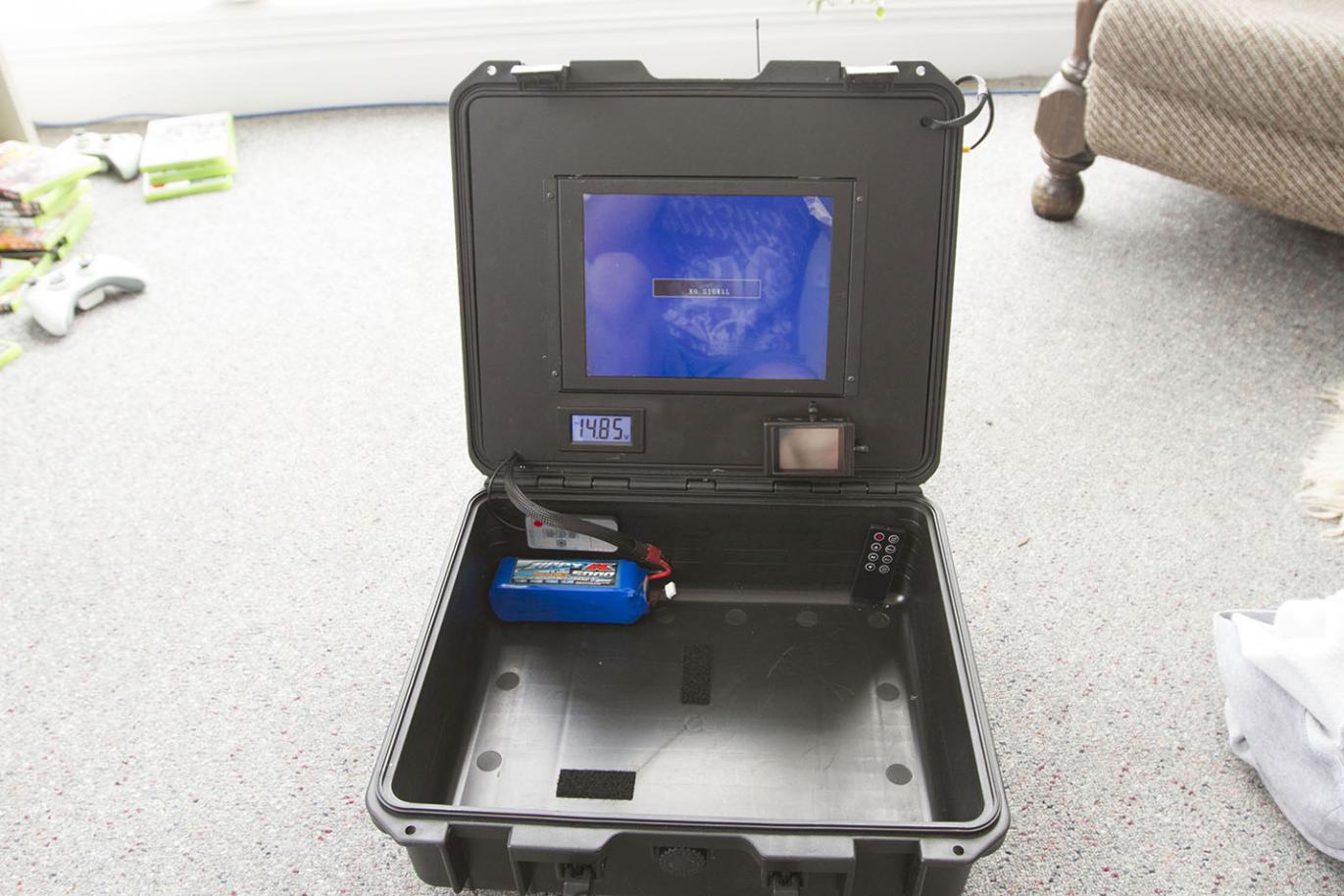

Ive finished building the two ground station cases for video down link and fpv.

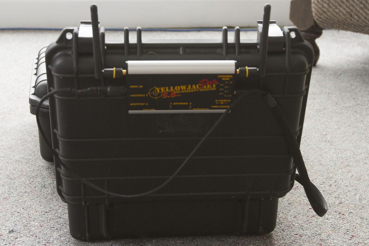

5.8 Downlink for camera operator:
-Iftron Yellow Jacket Pro
-Zippy 5000mah 4s battery hooked up to a voltage regulator dropping it down to 12v for the screen and Iftron.
-PYLE 10.4" screen, nice and big to see whats going on, its matt which is nice for sunny days(Its still got the screen protector on it, for now)
-Voltage display off ebay.
View attachment 8165View attachment 8166View attachment 8167

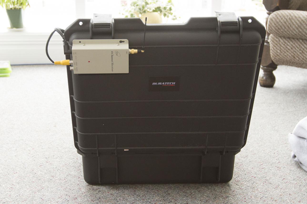

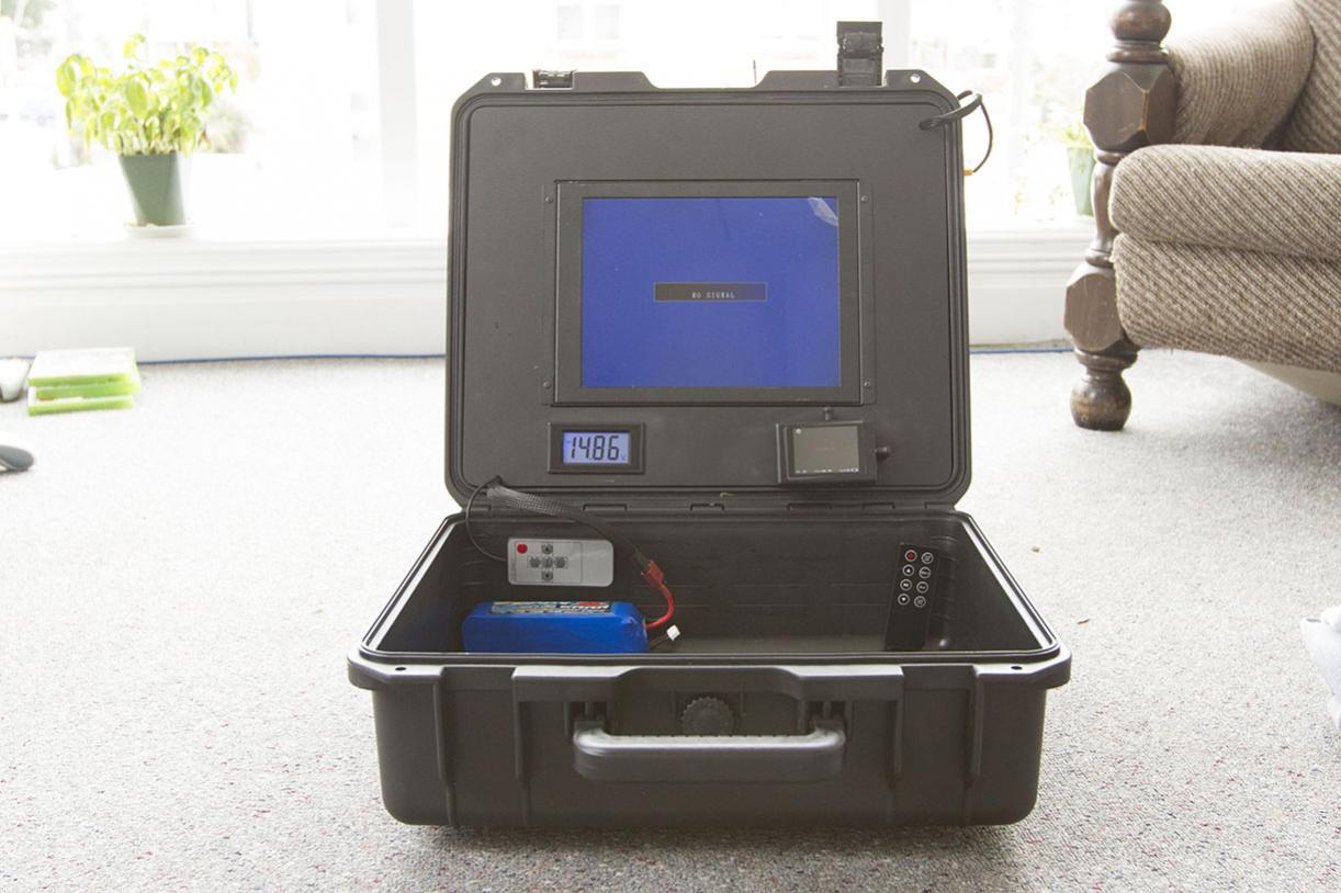

1.3ghz for FPV if needed, some shots will be at distance, so i opeted to build this just incase I do end up shooting far away. Il use this one for my TBS DISCO also.
-1.3 ghz transmitter and receiver from Ready made RC.
-Zippy 5000mah battery
-12v voltage regulator
-Voltage display
-Japan FVP recorder
View attachment 8168View attachment 8169View attachment 8170
I opted for the large 5000mah batterys for hassle free use on a long day shooting.
-The PLYE screens are the same as the ones sold at Quadrocopter for $395: http://www.quadrocopter.com/104-In-Wall-Mount-TFT-LCD-Flat-Panel-Monitor-_p_592.html. I bought it off ebay for $155 :http://www.amazon.com/PLVW10IW-10-4...TF8&qid=1355099950&sr=8-3&keywords=pyle+10.4"

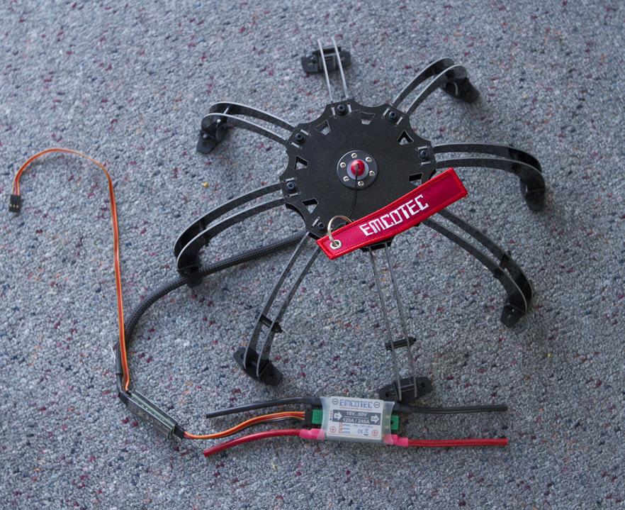

- Remote switch for the emcotec safety switch turned up today, so il have to do some soldering and then test it to see if I need a bec to power the receiver or not.

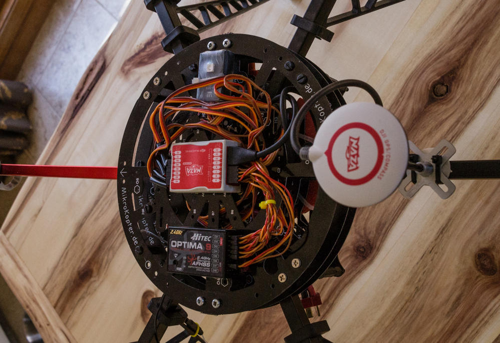

The Hurkules boards are here!
Today i drilled some holes in the skyjib top plate to mount the boards. I need to go and buy some longer stand offs to mount them.
So il get some pictures up tomorrow. I can finally start putting this together. :)
im try i promise. I just need to work out how to use a servo tester to work out the end points of the ys-x6. so andreas can write some custom firmware for me.
Is that the very top part for the imu? Why do you want it more ridged? i thought the supplied rubber vibration isolation mounts seemed like a good idea?
I placed the Herkules on rubber standoffs then used the aluminium standoffs to mount a carbon fiber center plate on top to mount the FC. Since the Herkules heatsink predrilled holes do not line up with any on the SJ V1.
The IMU should be mounted securely. Rubber standoffs will not do.

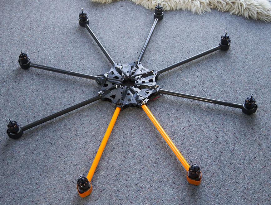

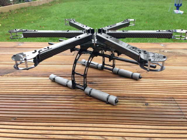

Heres yesterdays /this mornings progress. Not very much, trying to get my head around how to set up ys-x6 and herkules.

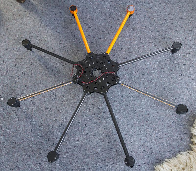

Ive assembled the frame, the cage has been left off so i cant work on the electronics. I had been planning on running it as a + configuration rather than an x, as seen here. That would have allowed me to run the leds on paralell arms.
But a few problems i ran into. ys-x6 led mounting, I wanted it at that back for best visibility and looks, I would rathter not have it off set to one side :)
and the skyjib battery mounts which aren't on here but bolt on to either side of the fame. They would have been at 1 and 6 o'clock. It shouldn't have been to much of an issue for weight distribution. But it would have been strange. Now they will bolt on at 9 and 3 o'clock.
I enlarged the hole on top of the crash cage to install the emcotec magnet.
Thanks to Elflier for covering two of my booms in fluro hanger 9 ultra cote. I spent 6 hours trying to get a good finish and couldn't. So I asked a pro :)
View attachment 8939View attachment 8940View attachment 8941View attachment 8942
