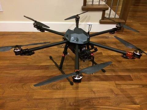

Yes, a Wookong that's not triggering a zen works fine with photogrammetry. I just wanted to clarify that so as not to confuse anyone. But compared to using Mission planner with Auducopter autopilots it's pretty clumsy. This is one of my mapping units that's still using a WooKong. View attachment 18548
