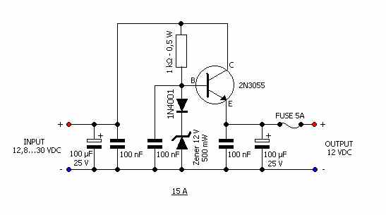

I made a 3A 12v supply...the trouble is that when dropping from 22v down to 12v it produces a lot of heat & therfore the 3A became about 400ma!!!! I did find a replacement chip & new circuit diagram that gave 1A @ 12v.
Try this:-
Ross

thanks guys. I was already thinking about using the extension board from MK but if I see right it provides 1A which i to little for the leds.
Macgrafs your approach i way over my skills i wouldnt be able to create something like this !
