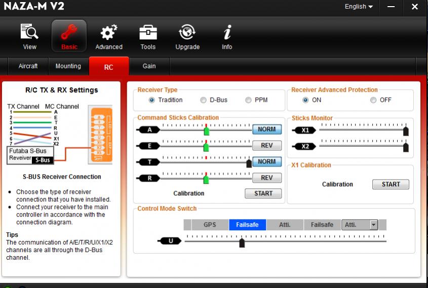

thurcombe, sorry for confusing you. I'll try to explain myself a bit more.
There are multiple ways to get the Naza into Failsafe mode.
1. The easiest way is using the Naza Software Assistant, you can configure the U channel to be GPS, ATT, FS, and giveup usage of MANual mode. I personally do not like this because I want Manual mode available if I need it.
2. Setup the Naza for the U channel to be GPS, ATT, MAN, but then have the transmitter send a value (based on a switch) for the U channel to be in between those three mode into the region called Failsafe. This is something external to the Naza, and requires special programming in the transmitter. Sadly, I do not know the DX6i transmitter, so I can't help there, but I would search YouTube; that's where I found out how to do that for my Futaba. Basically you are going to do a "mix" of two switches. One three-way switch that commands max, middle, min values which associates the three positions to the three flight modes. Then you "mix" in another switch which adjusts that same output of the 3-way switch to force a value in the in-between area. This way you can trigger the Naza into Failsafe with this other two position switch.
The above two methods are the pilot triggered ways of getting the Naza into Failsafe, and it is advisable that you setup one of those two. However, there is the true Failsafe intent which is the case when communication between you and the Naza is somehow broken, typically because the receiver is no longer receiving the signal from the transmitter. That is the transmitter/receiver failsafe programming that everyone should also setup. If this is setup correctly, the Naza failsafe will kickin if power is lost to the transmitter, or the signal is lost because you flew out of range. Again, I don't know the DX6i, so I can't give you specifics. But the jist is that you program each of the outputs to a specified response if communication is lost. So on my Futaba I have the throttle output set to 25% if the signal is lost, and the U channel set to a value that puts the Flight Mode into the Failsafe region.
So all of the above settings/programming should be verified on the ground with the Naza Software Assistant running to confirm the Naza flight mode is truly "Failsafe". Then, once you have confirmed that, try invoking Failsafe with one of the switched methods. Once you have confirmed stuff and you feel confident, then maybe you can try the loss of power method, but just be careful. I have tested it that way, and as soon as I confirmed it was returning back home, I turned it back on just to give me that piece of mind.
As to another question you had earlier... "Intelligent" shutdown is what I prefer, so you're fine there. I was just wondering why your MR just fell to the ground, and I'm guessing the Naza is getting a zero throttle input when you power off your transmitter. You can double check that with your Software Assistant.

Ben, thanks for your help, I do appreciate it but I DO have the failsafe switch set. It shows me failsafe in the assistant status bar at the bottom, then I left that switch in the 1 position which is failsafe enabled before binding. I will video it when I get time so that you can see. Just going back to the equipment, the naza cost me almost £400, I can buy a laptop for that kind of money and still have change for a £10 plane finder that plugs into my Rx and can detect when Tx is lost so yes, i'm a little unhappy that the naza cant do this itself.

I worked out it wasn't the reversed switch causing the issue. I assigned my failsafe to the gear switch though, not the gyro switch and I can see it select between GPS and failsafe in the assistant, here is a screenshot from my assistant that shows that.View attachment 13612
I read the manual and as i posted before the manual states... "With SmartSafe, when signal is lost the throttle channel only is driven to its preset failsafe position (normally low throttle) while all other channels hold last command"
Unless that is deliberately misleading, it sounds to me like the failsafe works only with the throttle channel. After reading the helifreak post I now see that it is a little misleading as it depends what you do with the bind plug when binding but as I said in a previous post, I have tried binding (Soooo many times) with the bing plug in and the bind plug removed but I have just tried it again following the instructions on the helifreak thread, this time I left the throttle at 100% just for testing so I could see after the bind if the throttle jumps to 100% after Tx poweroff, which it does. It doesn't put the naza to failsafe mode however.
Maybe i am still doing something wrong but I don't know what, like you said binding is binding... clearly it has been binding fine hence the 100% throttle when I turn off the Tx
Maybe it is a timing issue, maybe im not getting the bind plug out quick enough but that seems silly to me, as long as it is removed before the Tx is turned on to bind it should make any difference right?
