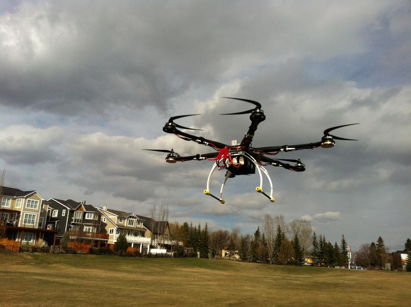

View attachment 11366View attachment 11367I have the complete RCT800 which includes both arms and plates and yes, the plates are identical to the DJI F550 having the power distribution built-in.......
only the tradmark/namebrand is different.
Also I added the clone S800 landing gear which is also identical to the original DJI landing gear w/o retract capability. http://www.rctimer.com/index.php?gOo=goods_details.dwt&goodsid=879&productname= also added two of the following: http://www.rctimer.com/index.php?gOo=goodspic.dwt&goodsid=840
THINGS TO WATCH OUT FOR:
1) The RCT800 arms are not designed to accomodate the standard DJI S800 landing gear so some modifications are required.....
2) I had trouble screwing in two of the machine bolts to the landing gear until I examined the holes and discovered that the manufacturer missing threading two holes..... bought a drill and tap and presto..... problem solved. BTW - I have been flying it with my WKM GPS control system and am very pleased with the performance......but especially the excellent pricing.
Some might complain that RCTimer is not playing fair by cloning other products and deeply cutting prices.
My opinion is that some of these items are earlier generation products that DJI has since evolved forward etc. and I like the DIY concept and don't want to pay for additional features that are of little to no value for me..... here are a couple of photos......
