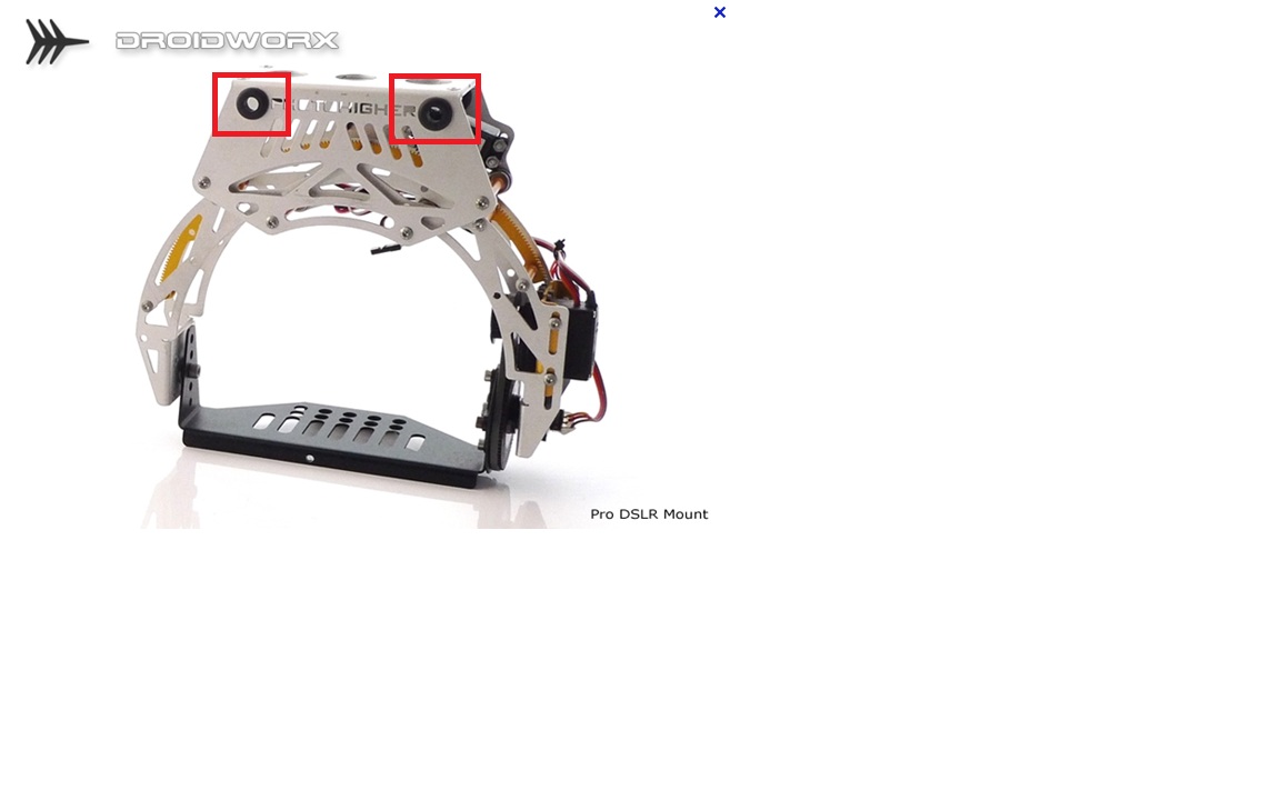

Can someone tell me the ID of the two mounting grommets on the AV130 gimbal? Also what seperation distance there is between hole center to hole center (how far apart the two holes are?)...

Ok. Its sort of hard to explain with the written word.
I am looking for the internal diameter of the two grommets located within the two red boxes. Also am searching for the distance from center to center of those two holes... *see attachment*.

The carbon tubes that go through the grommets are 7mm and you want it to be a stiff connection here. I actually replaced the grommets with delrin bushings and replaced the 7mm carbon tubes with 9mm tubes to get rid of the flex.
