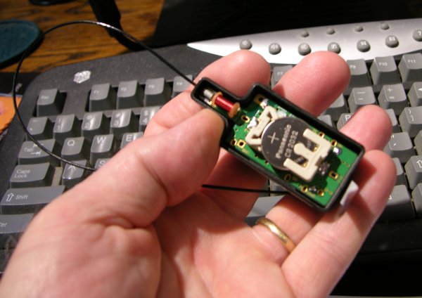

The transmitter beacon is a AT-2B which transmits at 50 mw. I live in Ohio and we get a lot of freezing weather come winter. I discovered that the beacon stops transmitting within a couple of hours if exposed to freezing temps using the stock CR-2032 button cell. So I had the manufacturer make mine using a CR123A lithium battery. I threw the tx in the freezer for a full two weeks and it was still transmitting when I pulled it out. The antenna is flexible wire so it can be strapped or left to dangle.
I;m showing a stock and the modified beacon for reference.
