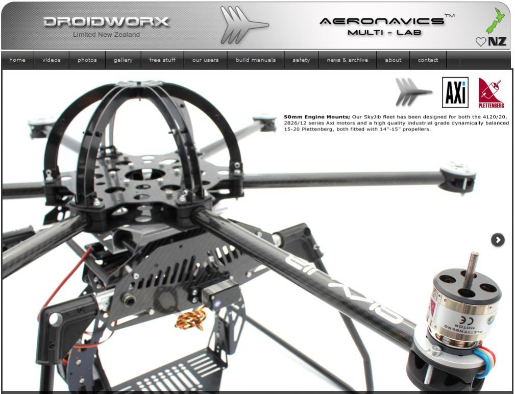

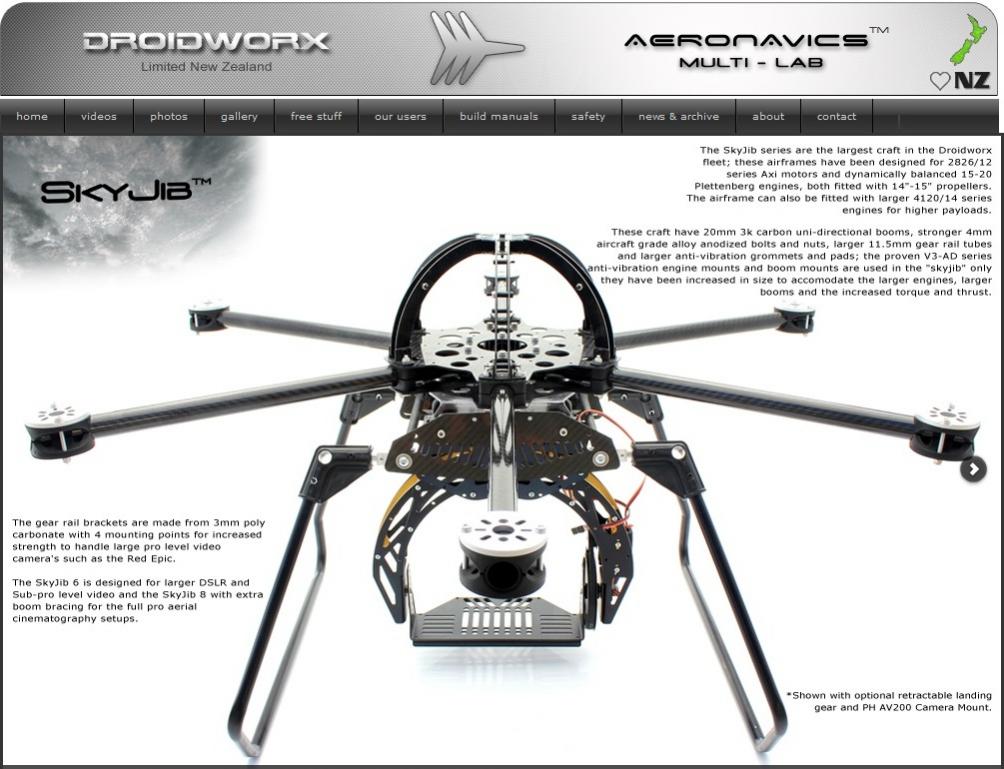

The motors as far as I know and search, and as far as other members ask the question, that the motors Plettenberg 15-20 where not on the Plettenberg website the answer was that this motors are a special edition and you can only by them through Pano-Dirk so how did Plettenberg recommended the prop size if the motors were not on their website for us CUSTOMERS to read.

Dirk's claim isn't the only reason I ordered the Pletty 15-20's for use with 14-15inch props on my SkyJib 8 with AEROdrive 8.....
Even the AXI4120/14 specs don't recommend 14 or 15 inch props. What gives with these people?
Munch
Well, the AXI 4120 are doing well with 15", but they are quite heavy and you will have to go with more batteries in parallel which again add more weight.
I think that in these heavy weight class, you have to calculate some spare money for trying around. I hate being the beta tester, but more and more things have to be reworked to get the best results. Gimbals (potentiometers, servos, ...), camera stabilizations come with buggy firmware, etc.
Well, the Plettenberg case is something special.
