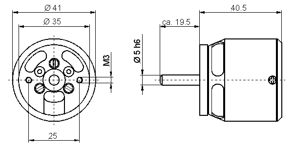

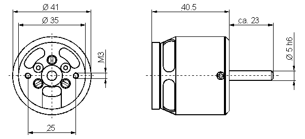

I'm guessing that DW need a special plate not because of the size but the odd mounting holes. Plus there's an optional "bigger" mounting plate with different holes again - but I might mill a similar piece myself that extends out to meet a mounting bracket coming off the arm. All very different from "normal" motors!

Building a "super-heavy-lift Y6". I agree most of the Plettenbergs are high Kv motors for racing - but not this model. Axi would be a better choice if they made a motor that performed similarly - but they don't :)

the Plettenberg engine on the DW website is a new special version. This engine is NOT on the Plettenberg website.
To change some important details for the DW frames is my idea. I am working together with Plettenberg and here are some details:
- new titanium axis (7 gram less)
- screw thread on the axis (no propeller mount needed, 20 gram less)
- lower KV
- dynamically fine balanced
Droidworx has received the first prototype from me.
I will give some more details about power, thrust and so on in the next days.
