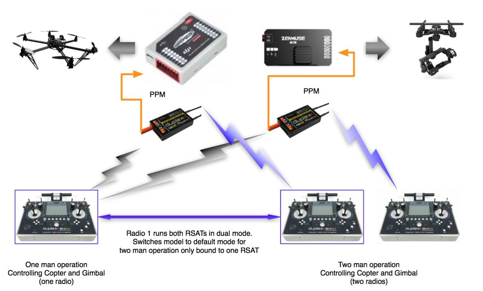

Hi guys,
That feature request was made by me. Now, less than 24h from my request, it is operational beginning with firmware version 58.27.
I was requesting a brake signal from the Picloc, to be used in my 3 axis mount when operating pano in manual mode. In order to make the pano gimbal stay where I left it, no matter vibrations, brisk yaw manouvers and the fact that a 360-modified servo (as normally used for pano) has virtually no inherent holding power. The pano break mechanism will compensate for the absence of pano servo holding power during manual mode.
So when would I want to use pano in manual mode? Well, during FPV, WKM auto POI flying, sometimes during waypoint missions. Applicable both during single man and two man operations.
The signal to the break servo will be assigned to one of the picloc servo output channels S4-S6.
Here is a brief demo video:
This new feature is the remedy to a problem I have been pondering for half a year.
Thanks George!! :nevreness:
