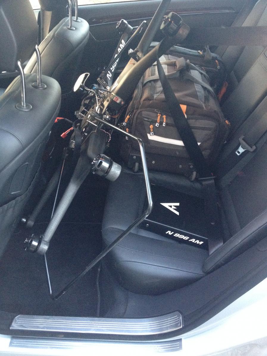

Earlier you said "This thing is massive, 1500mm with 17" props"
I can only guess when you say "still fits in my car", you are referring to a van, SUV, or pickup truck.

If I had that car, I can guarantee you the Mrs. would not let even my little quad in it, let alone that monster.

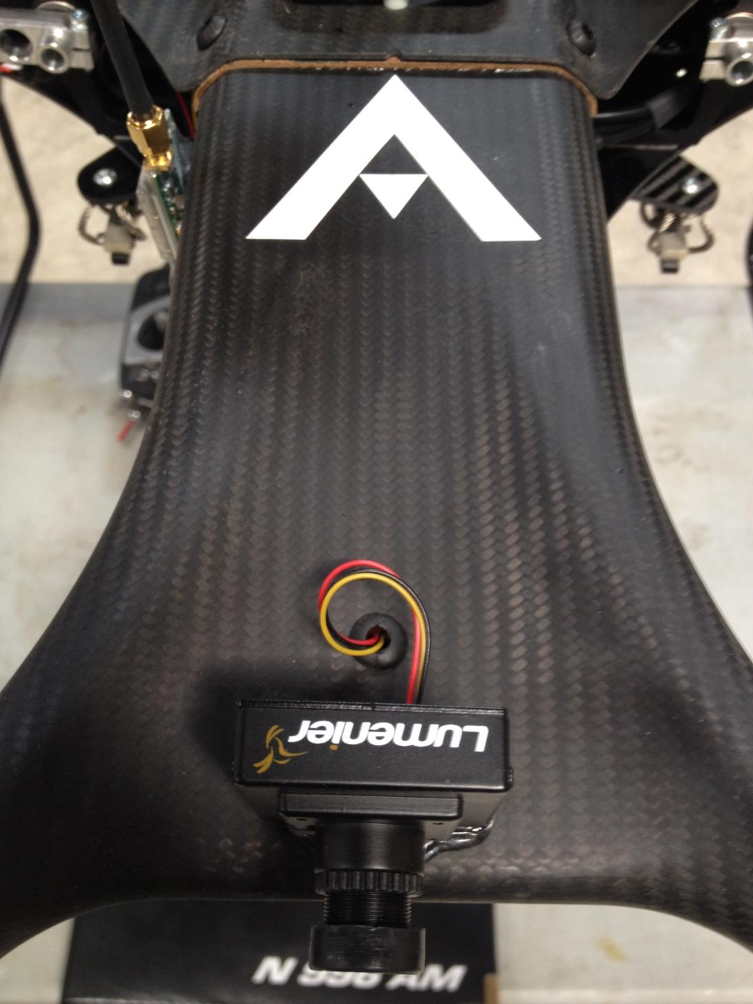

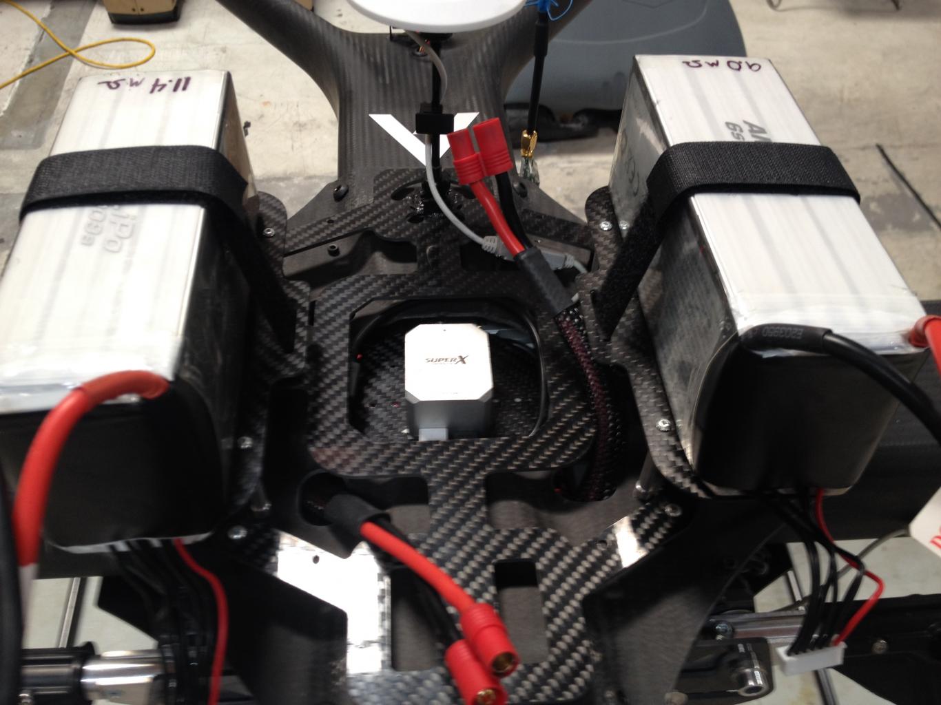

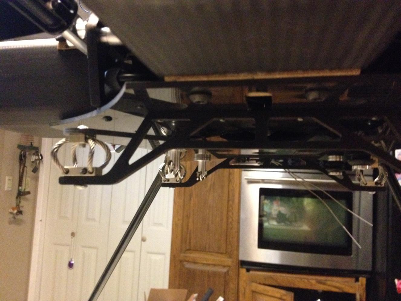

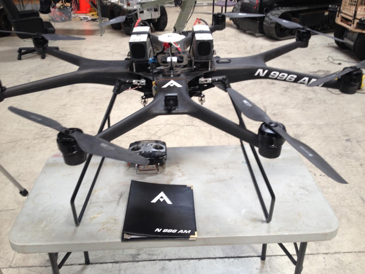

heres some pics of it at the shop....
attachment.php
attachment.php
attachment.php
attachment.php

Looking good kloner, let's see some video, please...
How do you like the Lumenier pilot cam? As good as the Seawolf Pixim?
I'm trying to break away this weekend to get some time built up on it and will make something to share. Been busy lately
yes i do like them, the view reminds me of how a nice camera on the gimbal looks, super clear. it's 800 tvl, and that on 5.8 is about as hd as sd can look
