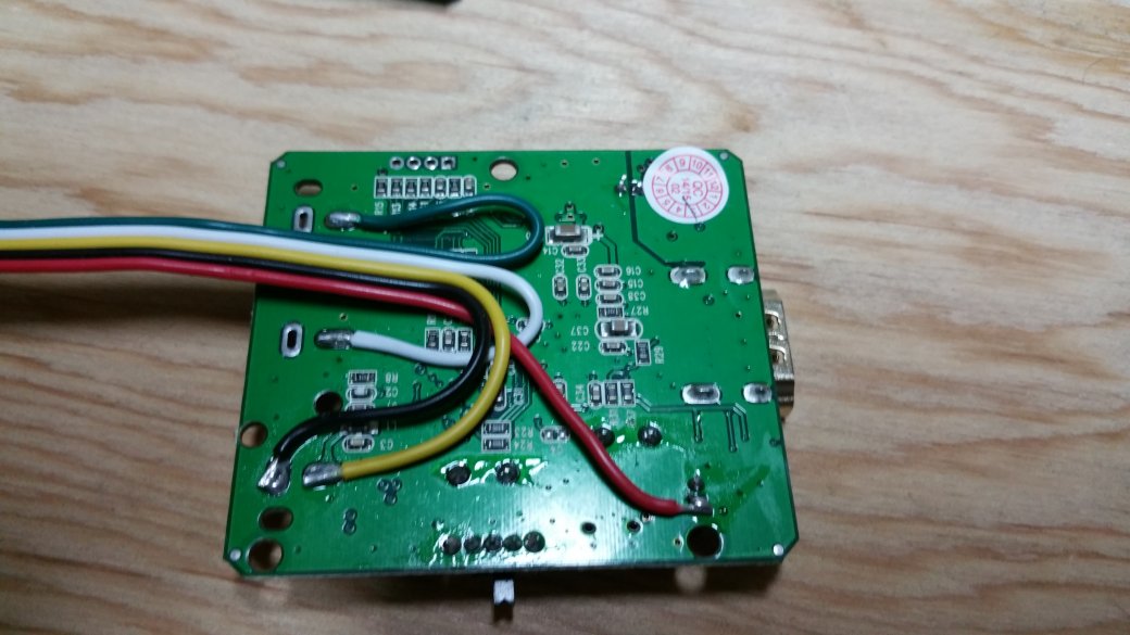

Kopterworx did the ground work. Found the right board, soldered a molex harness and shrink wrapped it. I don't blame them for charging $100. They are providing a service.
For the diy guys you can do this all yourself. The molex harness is available at hobby king for $1.

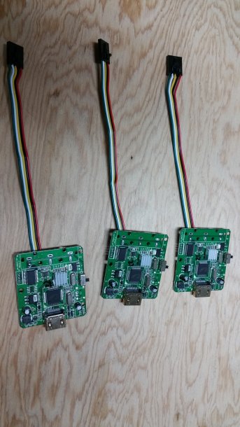

Here are the ones I got from goodluckbuy.com
I made all 3 immersion ready. Direct plug n play. All 3 worked with the gh4 tonite when I tested them. The switch position doesn't seem to make a difference. With ntsc anyway. That's probably why my kopterworx version had the switch removed.
