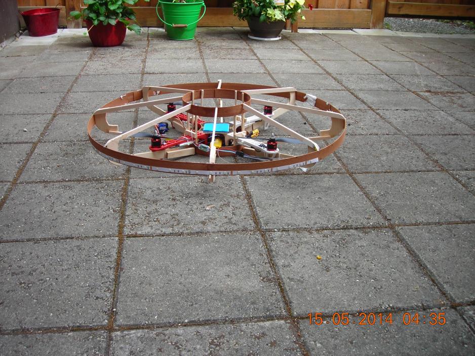

Thanks to the help of those on this forum, my fpv is all wired up and working... sort of.
Everything is fitted to the x650 and when I look thru my FS Attitudes I get a lovely steady glitch-free picture out of the camera. Cool.
When I start the motors and have them idling round (so still on the ground) there is still no interference.
However, when I tale off the picture starts to break up to the point where it is un-usable.
My ImmersionRC Tx is mounted underneath the body plates, on the outside edge. It is underneath the OSD module but separated from it by the c/f frame plates and about 1 1/2 inches of vertical distance
I have distance tested it while on ground and motors off - picture is rock steady at 100ft or so... length of mu garden :)
I am guessing that when the motors get to take-off/flight speed either they or the escs are generating some form of interference that is scrambling the video signal.
BTW the photo shows the Fatshark antenna in a horizontal position. but I have also tried it in a vertical (straight down) orientation and it makes no difference.
Any advice is welcome. Do these symptoms ring a bell with you? Where do you put your tx? Pictures?
My sincere thanks as ever,
Jonathan
ham stuff is all line of site,,,, if anything is between the antennas, make it so there isn't....
cp antennas have a null out the top and bottom, problem having it on it's side is the null can point at you..... kinda like up and down does straight overhead. never point the top of the antenna on either side at them selves
you mentioned it gets worse when powered up.... is the power wire for it soldered in well? right to a main distribution area? how many volts goes into it?
this system will run for a mile easily.... make sure the camera, osd and vtx are all in pal or ntsc
