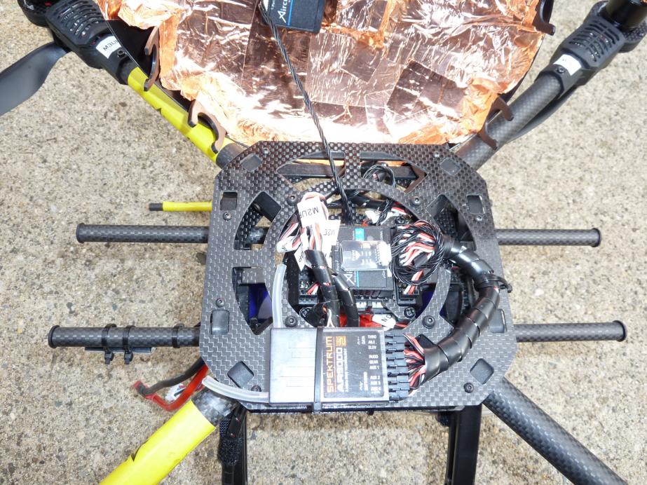

View attachment 1537 View attachment 1538 Here is the latest Flight Motion Camera FMC-5 It is using the CC board for camera IMU.
It uses the rigid balanced beam system with a 3 axis camera mount. CC board is currently fixed to the beam which floats on 2 " of soft foam. The shrouds have a vane that creates a side force as power is increased and this provides a more level lateral transition. Most of the mass is mounted on the beam. More follows in the next Vid.
We touched on the term slew mode a while back. Slew mode is when you lock the servo pot at its neutral position and the servo is modified for continuous rotation. This means that the IMU is the controller. As the stick movement increases it's travel away from the neutral point the servo will gradually and smoothly speed up in that direction. As the stick comes back to neutral the servo will gradually/smoothly slow down and stop in a new parking place. Unlike when you are in proportional mode. This is the way that most pro camera gimbal systems work, stabilized or not.
It is not quite that straightforward because if your IMU has any gyro drift (not temp. stabilized or seeing noise) then your neutral position will also start to drift. This in conjunction with higher sensitivity gyros is the area that I am working on.
