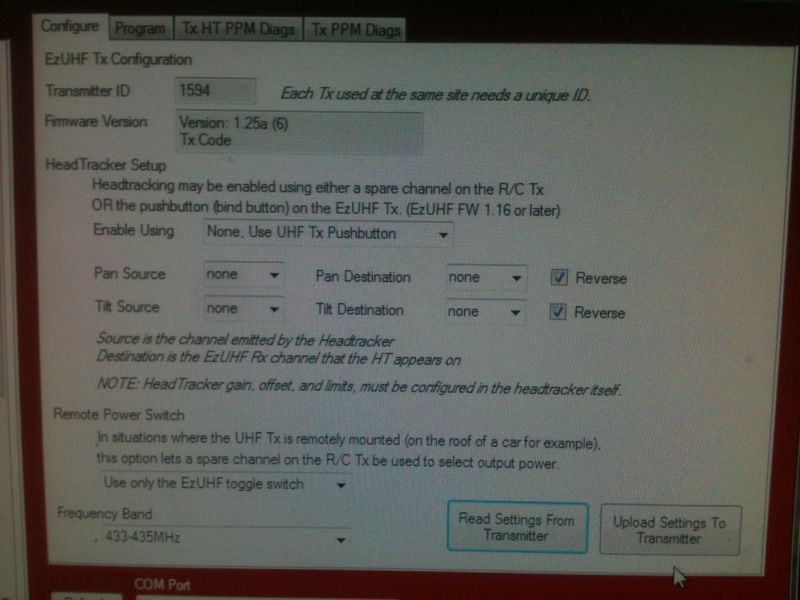

Here's what I see in naza and immersion tools config page.

stop trying to run naza, it's setup, any of that......go back to the ezuhf part. You need to open "tx HT PPM diags" and hit read, whatever makes it tell you all teh numbers and get a screen shot of that.
You started with a new model and didn't touch any programing, right? i kept seeing dx-7 and it was the trim menu radio...... got confused myself....
That screen is going to show us if your radio ppm is compatible

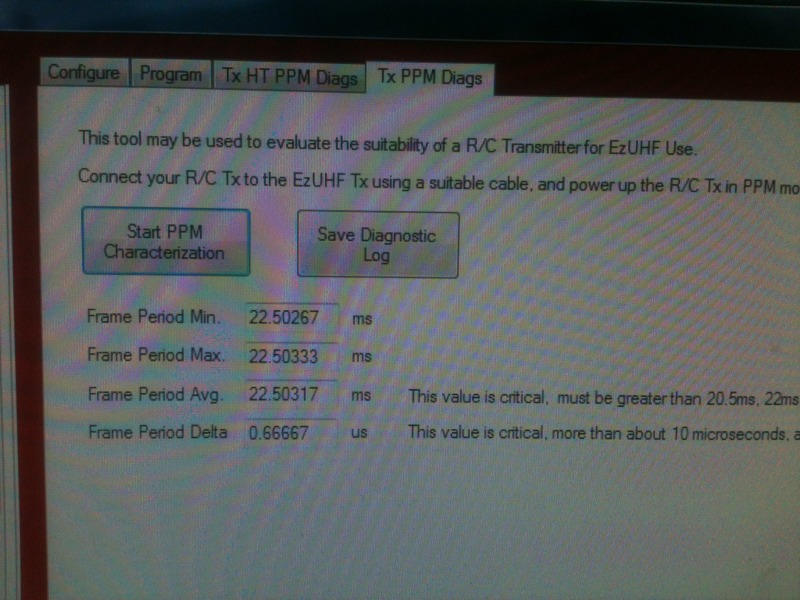

Couldn't get anything out of tx ht ppm diags but got some #s from tx ppm diags page.

ok, those look great. how is naza hooked up to this thing? ppm? if not, wire it up like that. You have to hook the receiver up to immersion tools and enable ppm, mikorocopter mode on ch1, run that wire to x2 and enable ppm in naza assistant

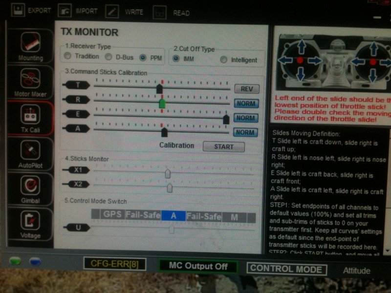

Ok, changed it all (rx and naza assistant) over to ppm and its not liking it. The channels are all mixed up and the cfg-err8 is lit.
man, we need a futaba 10 guy....
why is it coming through like spektrum? throttle is on elevator? move it back to 10 channel and see if that stays...... something is weird
That config error will go away when the throttle is on the right channel and it's calibrated again

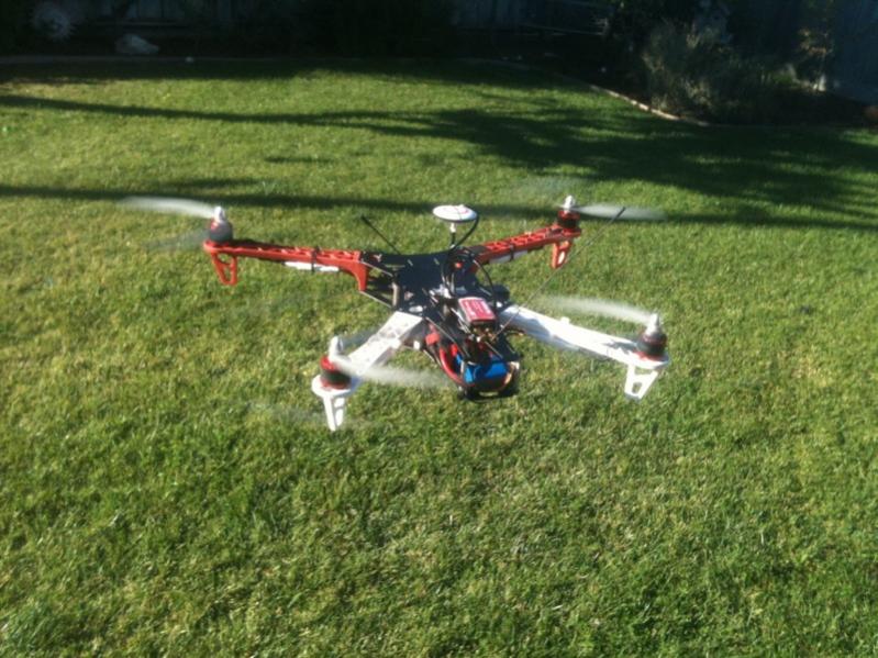

Well, I slapped everything back together, reinstalled assistant 1.8 and reconfigured everything on the fc. The sliders wouldn't get to green during calibration (1/64" off) but said fu€k it and flew it anyway. It flew GREAT! Better than it did before. Solid as a rock. RTH, GPS, Home Lock, Course Lock and gains on the dial channel worked perfectly. We'll see how it does in the long run. Thanks again, Kloner, for helping me out!

weird. Those are suppose to center and turn green when you click finish... oh well, have fun!
SAR39
Yeah, it's weird. Never had a prob before. Emailed DJI and they said to keep cycling the power. Didn't help. After searching the net last night, there are others with the same prob. Have 2 successful flights so far. Took it about 1/4 mi away and it was happy. Will prob order the ezosd soon.
