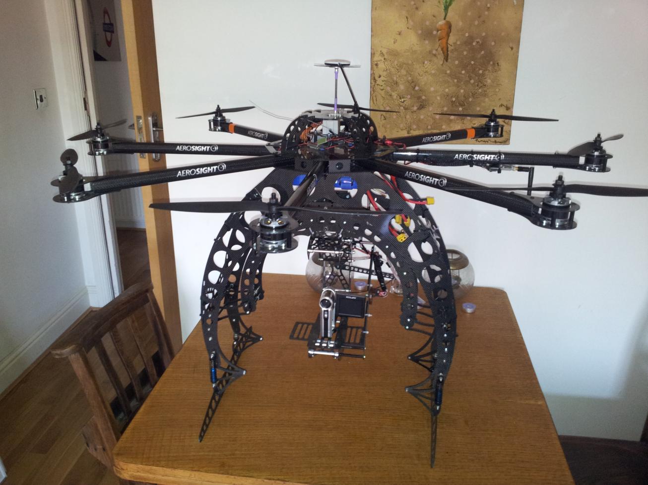

Flying this monster.. Note the cheapo camera for tests such as these..
Yes you now have to set home manually by switching between home lock and off three to four times, you will then see the green flashes indicating it was succesful, otherwise when you switch into failsafe or rtl it doesnt do anything, just drifts off.. Until you take control of it because it has nowhere to go so it defaults to doing nothing I suppose? I will let DJI know about this and maybe they will change either the manual or the firmware? It may already be in the manual? but like most men i tend not to read manuals :tennis: I actually prefer doing it this way? but there will be others that dont?

Ah! Carboncore octa and megaradius. I was so close to purchasing one of those! Love that big *** cam mount
