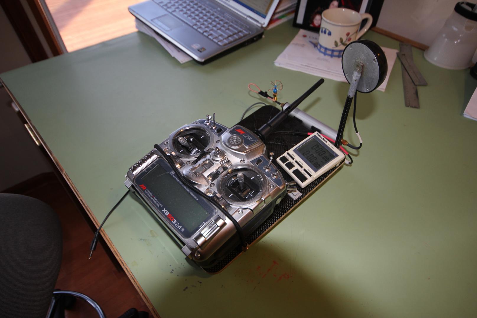

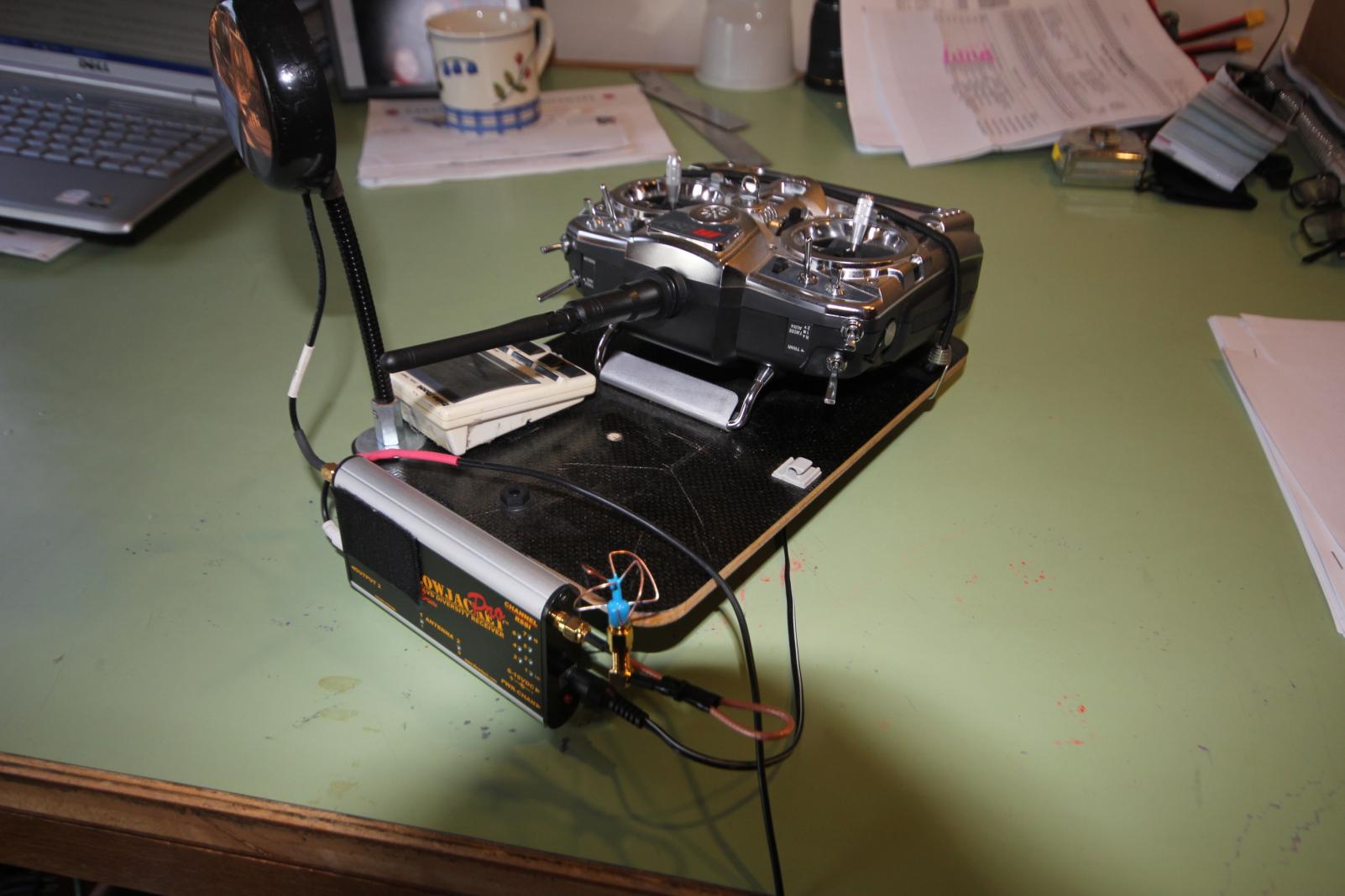

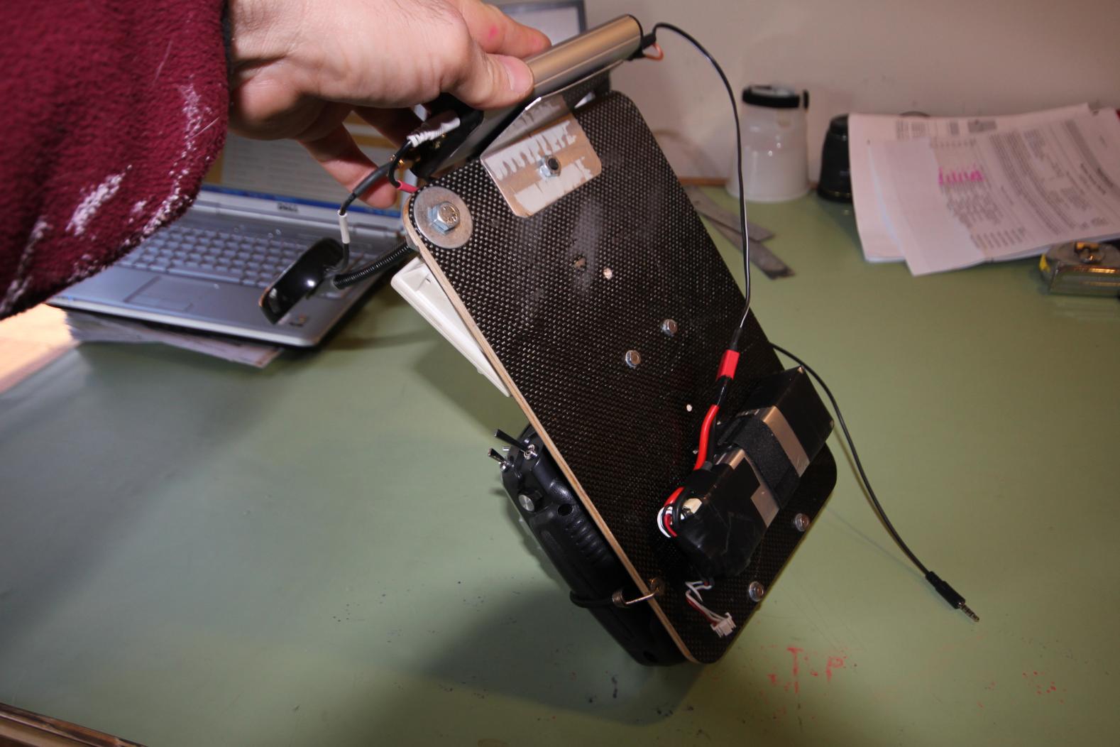

This is what I use instead of having a fixed ground station. Maybe it'll give you a few ideas for yours.
View attachment 1801View attachment 1802View attachment 1803
I clip my neck band to the transmitter and the whole thing hangs from there. The battery is a 3S (the three good cells from the four cell Vislero pack that I got with my first MK) Lipo for the Rx and my goggles have their own battery.
Bart

Nice set up, Bart. I'm working on something simular myself right now. I found a decent 7 inch monitor on amazon that I've added as well. I love flying in the goggles, but there are a lot of times when I would like to be able to bounce back and forth between LOS and FPV.
I'll post up a pic or two this weekend when I have some free time.

I like this. I am getting ideas...

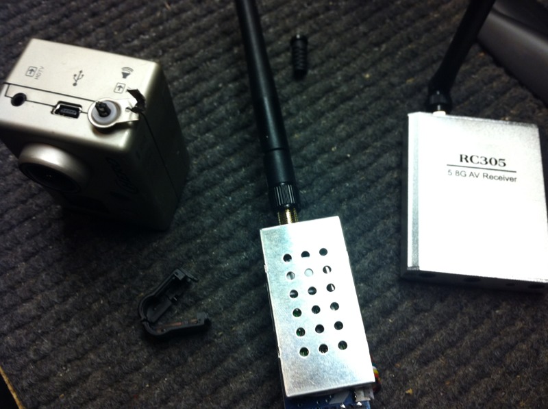

I finally got my vTx and vRx to communicate with one an other. First was the incompatibility between the two, RC305 vRx's do not work with Immersion vTx's. Got that fixed with an Airwave vRx. Connect everything up with my BlueBeam cloverleaf antennas and nothing. Went back to the whip antennas and voila I have a picture. I went back on line to ReadyMadeRC where I bought the antennas and there is now a post regarding an issue between the BlueBeam and the Airwave vRx. Here is the post that shows how to correct it:
http://www.rcgroups.com/forums/showpost.php?p=18484051&postcount=786
Seems the Airwave supplies DC voltage to the antenna and the cloverleaf design says to the receiver that there is a short. By removing a SMD resistor, very small, had to use a magnifying glass and my head mounted magnifiers, it fixes the problem and now everything talks to each other. Be careful in removing the resistor, it is very small and there are three others right next to it. Now to get everything mounted up and go flying. Santa brought me 3 new 3S 2650mAh lipos for my Naza quad. If the wind is calm tomorrow it could be a perfect day to do a little fpv. Merry Christmas to those that tried to help and to those that just watched me flounder, Bah Humbug!. Not really I hope you had a great Christmas as well.
