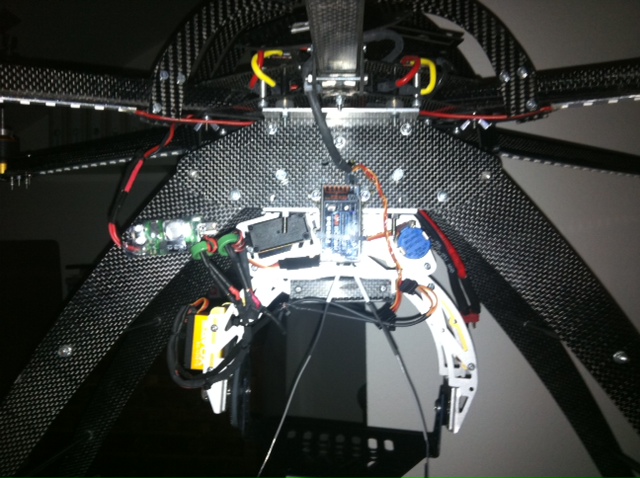

What this yellow tape construction you have your IMU mounted to. As far as I can see on my RC carbon frame there is a hole in the middle. Is this IMU frame connection really solid ?
Boris
BorisS
By the way i would mount the futaba on the landinggear sideways. If you look in the manual of the futaba RX the two antenna should be separated from each other on a 90 degree angle. Having it directly mounted on top of the plate and the antenna just munched in somewhere will not give you a good performance for your TX RX setup.
There is enough space in the RC carbon landing gear and if you move out the MC to the edges of the centerplate the cables between RX and MC should also be long enough.
