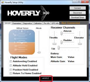

Sorry, I want to make sure this is super clear because it's very important. Everyone needs to go to Hoverfly's site and manually download the new setup client. The version of the setup client HAS to say v4.6.0.2. If it doesn't, your accelerometer calibration will not work correctly!!
http://www.hoverflyupdate.com/setupClient4.6/publish.htm
Can someone that is having horizon issues confirm that they have done this and have v4.6.0.2 and have run the accelerometer calibration with it?

Sorry to hear this. Can you confirm that you have used the v4.6.0.2 setup client to do your accelerometer calibration?
I have downloaded 4.6.02.
