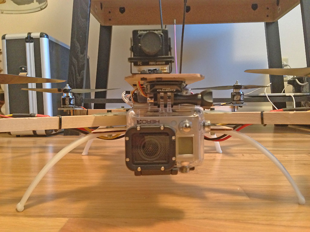

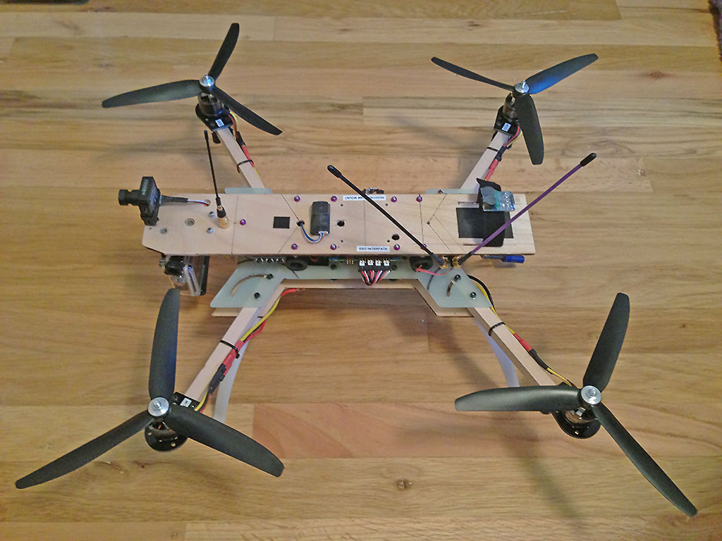

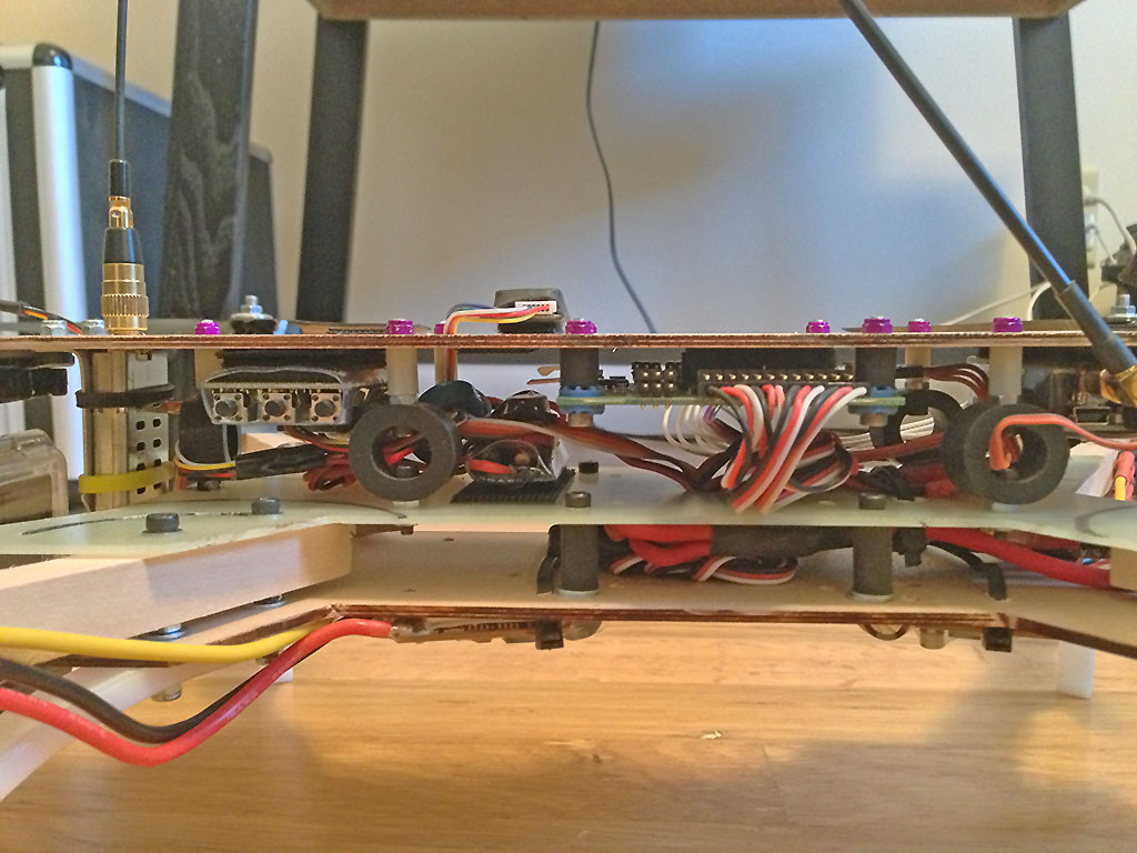

Hey Huck,
Thanks, I really appreciate especially given the awesome videos you shoot.
This baby is home made all the way, even down to the vibration dampeners :) I picked up some rubber washers in the plumbing department, drilled a hole all the way through and put a M3x10 bolt through each side. You can see them in these pictures. I used a white nylon extension to give my top platform a little more height.
View attachment 7795View attachment 7796View attachment 7797
