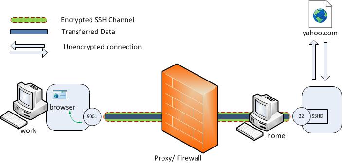

Hi Simon ICMP/ Network ping is port independent try pinging your machines in your home network and you will get a ping response even if your port 80 isn't open, thus having a service running.
The only work around that could work for you at moment if your ISP doesn't change anything, is using a ssh tunnel. For example if you have a linux/unix/os2/ machine in your office or somewhere else that you can access via ssh, you can create a ssh tunnel. Letting your machine listen on the DJI ip/host port 8080 with a putty client for example ( port 8080 not sure if its it, but you checked it via netstat) and also tell the tunnel hosting machine in your office to forward connections to the external DJI server.
The question is only if the DJI client is resolving or connecting directly to an IP. If its resolving an domain for example you can help your self locally on your machine by changing your localhost file that the DJI domain gets rerouted to your local machine with the open ssh client port hosting the tunnel for. If its connecting to an IP i am not sure has been a long time since I was dealing with networking stuff.
http://chamibuddhika.wordpress.com/2012/03/21/ssh-tunnelling-explained/

Thanks Boris - I understand, but would rather understand (& fix!) the root cause, rather than tunnel via a proxy / alternate host (also, not an option for me as my employers network - a bank - is locked down for remote inbound access inbound!). I have a workaround, for me, in that I can use my Verizon Mifi router when I need to (4G LTE) - but it's annoying to power that up & switch my laptops Wifi over just to use the WKM software & I don't like it when things don't work properly.
I used a packet analyser to look at the trace & the application is going explicitly to an IP address, not via a DNS name.
