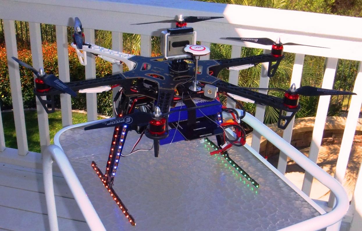

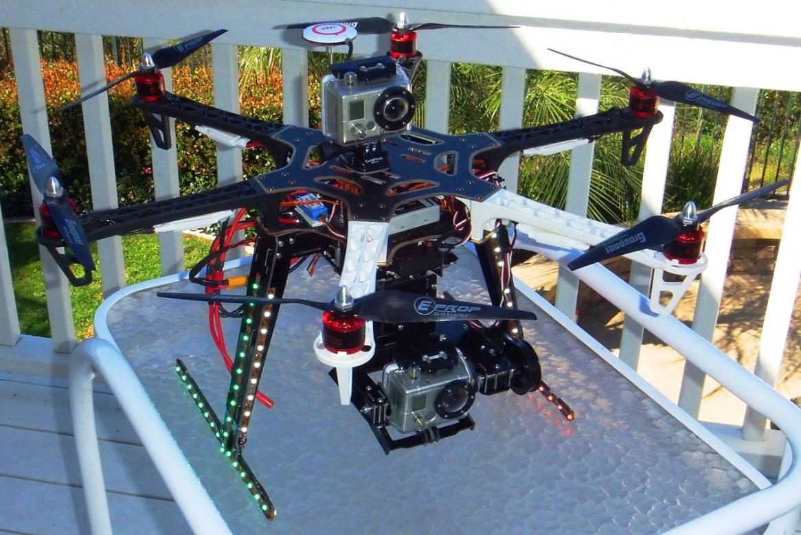

Sorry for not keeping this thread updated. I've been busy testing some last minute changes/improvements, and I wanted to thoroughly test them first. Basically, what I've been working on is better vibration isolation. With some help from Chris, at Vortex Aerial, we found that the pool noodles I was using, were causing a low-frequency oscillation, mainly due to prop wash. I've now removed these, and have added some LED strips, to help with orientation.
We also figured out that we need a different scheme for the first-level isolation. We found some silicon 2-piece grommets that are extremely pliable. Anyway, these have really cut down the vibrations. We did a test where Chris hovered in front of me. I could touch the F550 legs/arms, and you can feel a strong vibration, almost teeth shaking.:eek: Anyway, now when you touch one of the landing gear legs, or one of the skids, you just feel a very slight vibration. When you touch the mounting plate/battery tray, you get nothing. :)

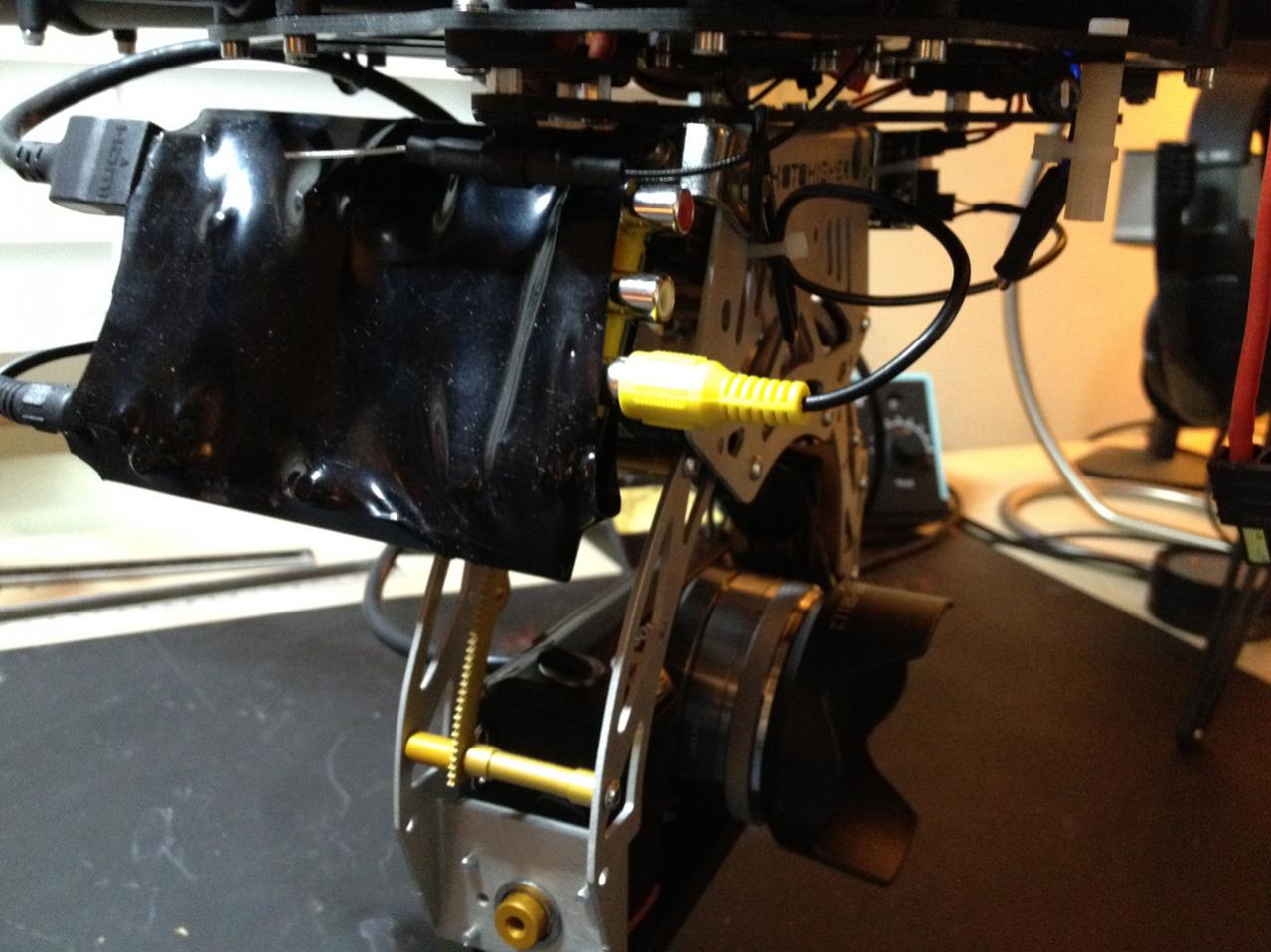

Hi Gary,
I agree with your conclusions. I "follow" your experience with a build of my conception for my Gopro.
I used Hyperion servos for the raisons you explained with a not to bad result. Until now I have not yet finished my trials and errors but results are pretty good for me.View attachment 3088
