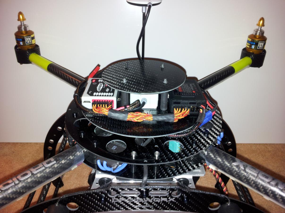

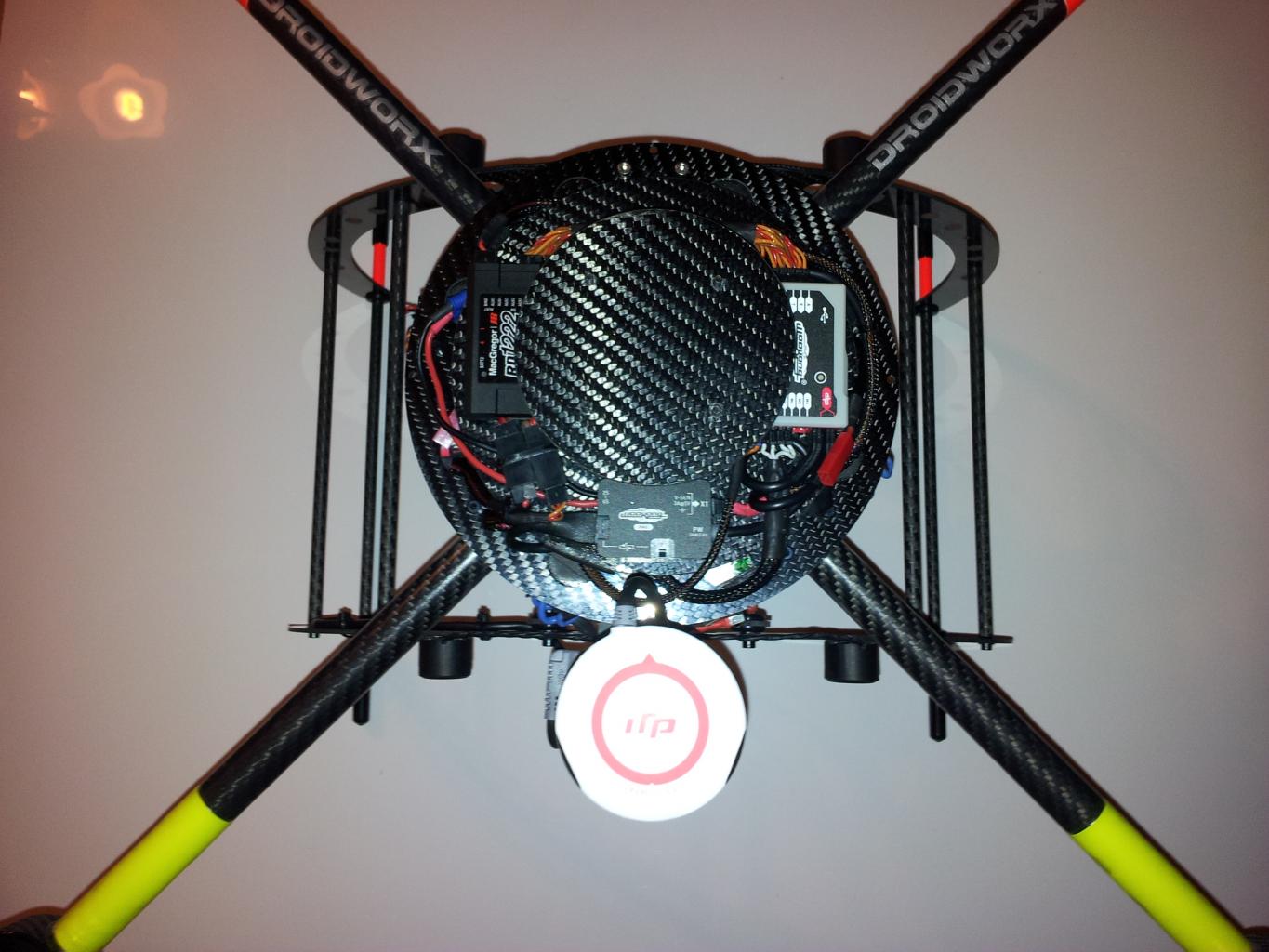

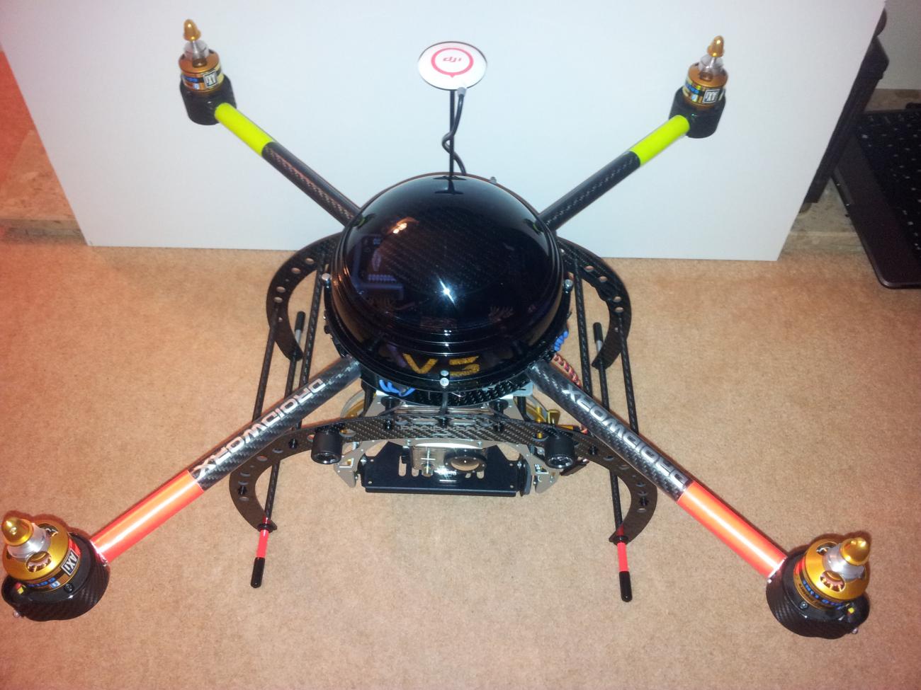

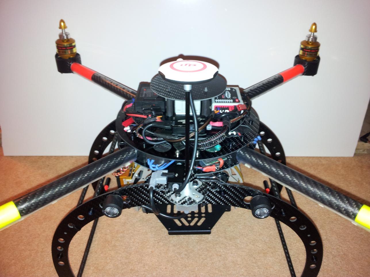

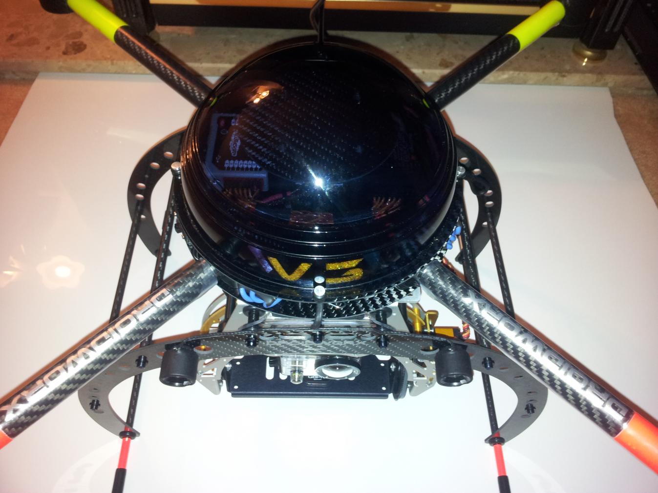

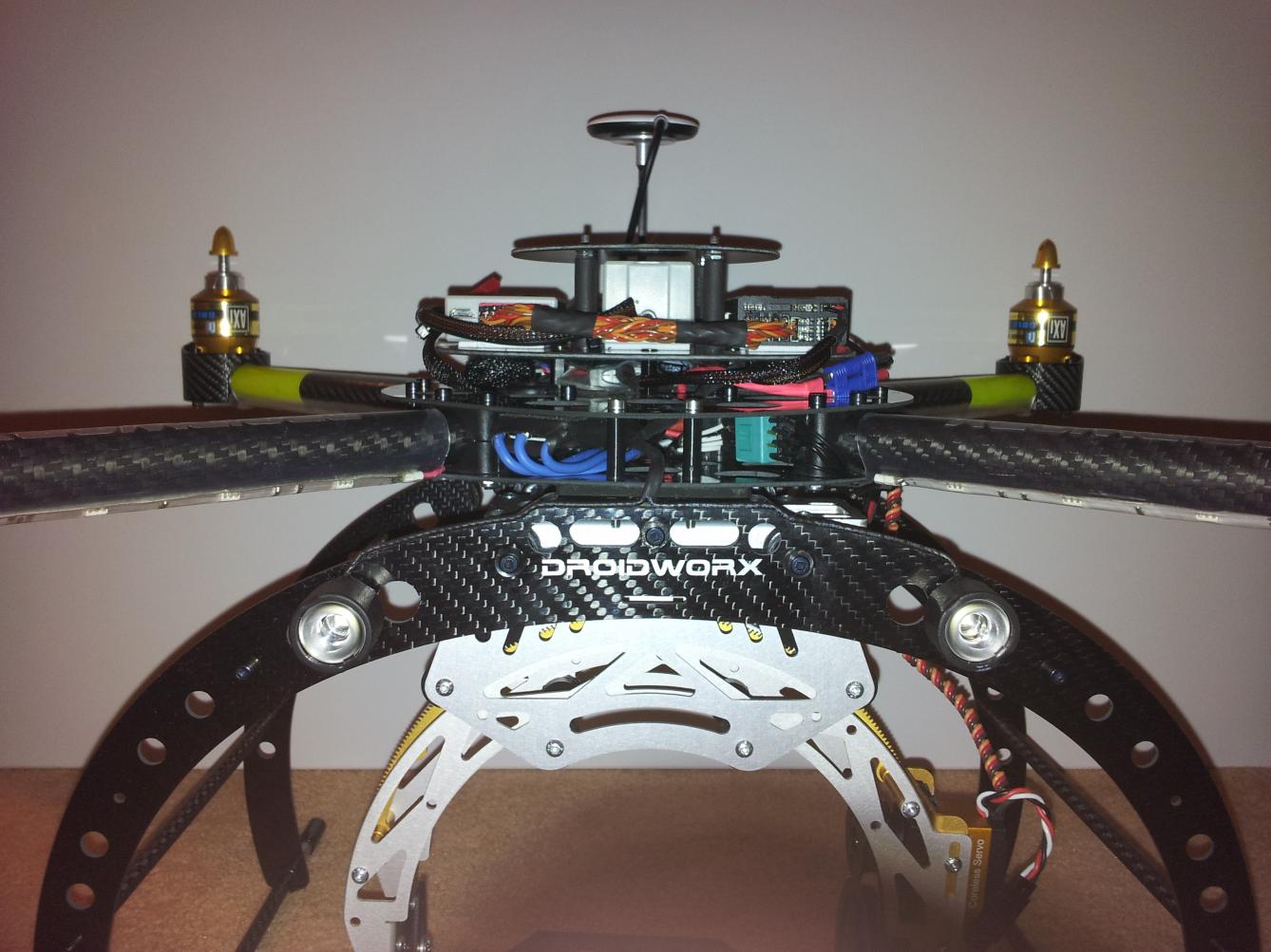

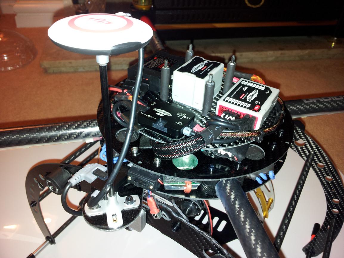

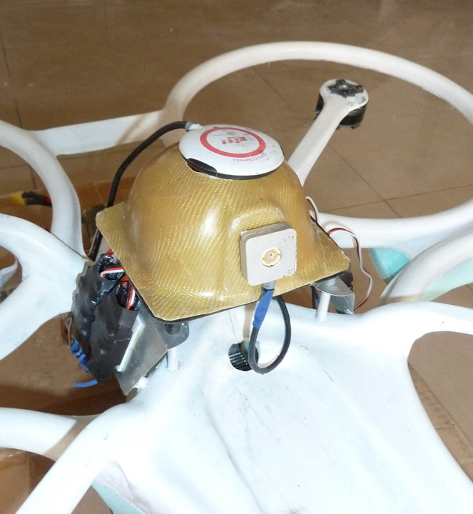

Well I finally got the rig wiring all done last night, only the props to put on and then for the final dialing in. I ended up putting the GPS on a plate I made to stand off outside as far from the rest of the electrics to try and save any problems.
View attachment 2580View attachment 2581View attachment 2582View attachment 2583View attachment 2584
In the morning just got to tint the canopy, and then wait for some decent weather, otherwise its getting tested in the living room so long i dont take out another plasma lol.
View attachment 3870View attachment 3871View attachment 3872View attachment 3873View attachment 3874
Seriously?? Wow! I thought I made a clean build. That is a thing of beauty. Amazing job Rob. Can't wait to see it fly.
I'll get you that night video soon.
Where did you get those flood lights? Love them!
Cheers!

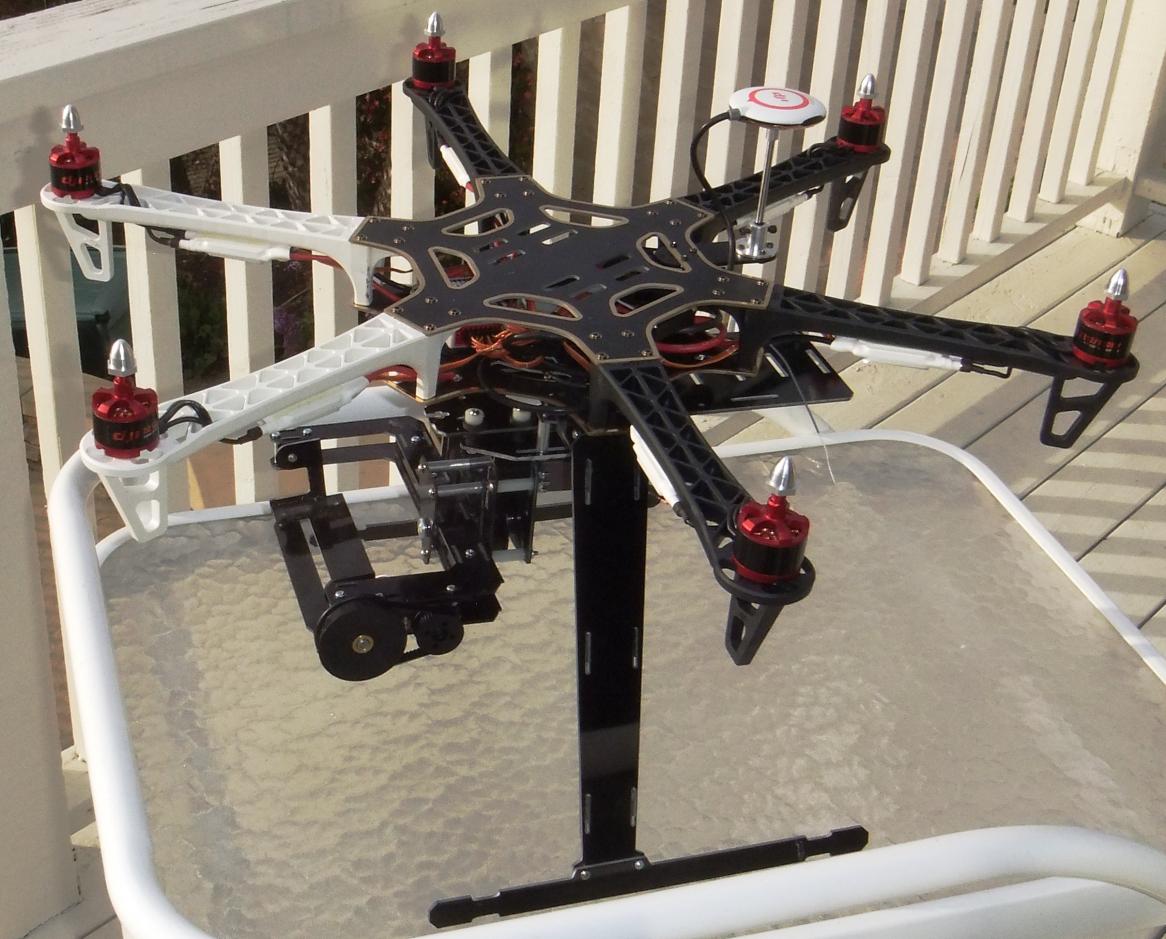

Just a quick note of some the changes I made and their effects:
1) Switched out the APC 12x3.8 props with Aerobot 12x3.8 Carbon Fiber props
- ESC's are running about 10-20 degrees cooler
- Less vibration (could be they are balanced more)
- Look really cool
- Stability has increased
2) Started running 2 x 6200mah 4S batteries in parallel
- AUW now 3515 grams
- Flight time (until first low voltage warning) went from 9 minutes to 15 minutes. I then have about 2 minutes before final warning.
3) Balanced the motors
- 3 of the motors were balanced really well from the factory
- 1 motor I balanced with a small piece of tape. It's much better but doesn't match the balance of the other 3. I'm wondering if the balance of the prop adapter is off and not the motor itself.
- Noticeably less vibration

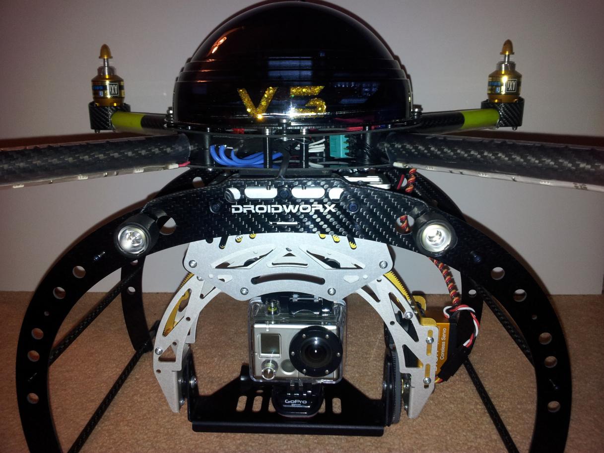

AIRCONROB

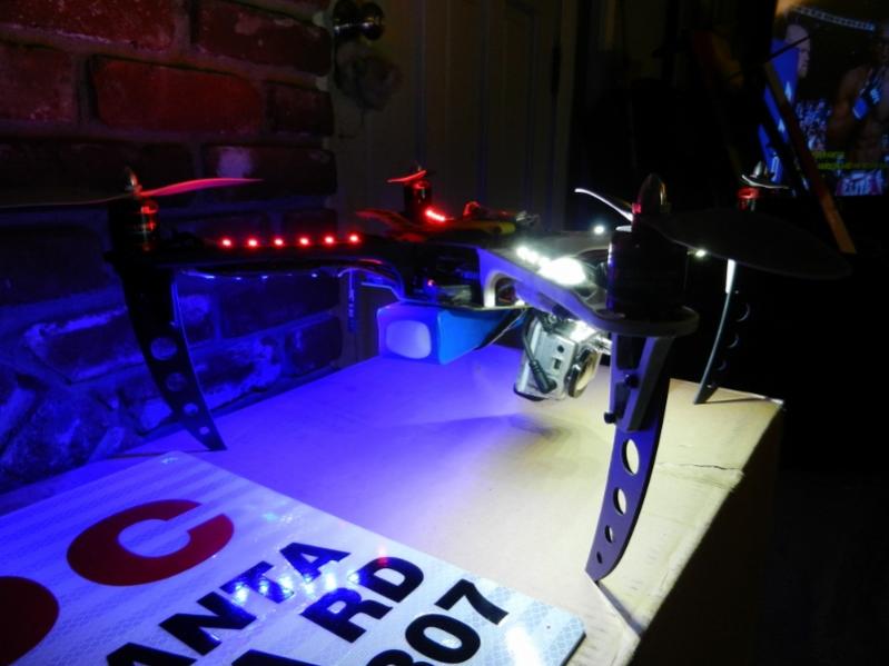

Hi Steve, They are, [h=1]Flexible RGB Strip Lighting Kit[/h]From Maplin only £29.99 The only thing you have to do is take the board out of the huge box, stick your wires on and heat shrink it all. That makes it smaller than a match box.

robvree
Hey Rob, have you tried your Lights out at night yet? Canopy complete, not aswell as a axpected but it will do, I just want to get it up in the air now.
Mybe we can get started with Club Quadworx, a little teeza for you mate.
I'm not worthy... I'm not worthy... :highly_amused:
Maybe I missed the part about you creating a full on light show. That is freaking awesome Rob. Good job. The floods and ground lights are my favorite. You need to collect all the articles about the increase of UFO sightings in Cheshire once you get it airborne.

Thanks for the comments, talking about UFO sightings, when i got my Flame 450 and just test flew it in the garden it was dark as i wanted to see how the lights worked, within half an hour had a knock on the door by the feds asking me if i'd seen any anusual objects flying around the gardens. Well I don't know how i kept a straight face but i did, the neighbour 4 doors away is about 70 reported it as it nearly scared her to death. Upto this day she doesn't know it was me lol.
And yes I was tip toeing around the house just testing the floods to see how and if the camera sees enough. Believe me if i kicked her up, the wife would of pasted me lol.
