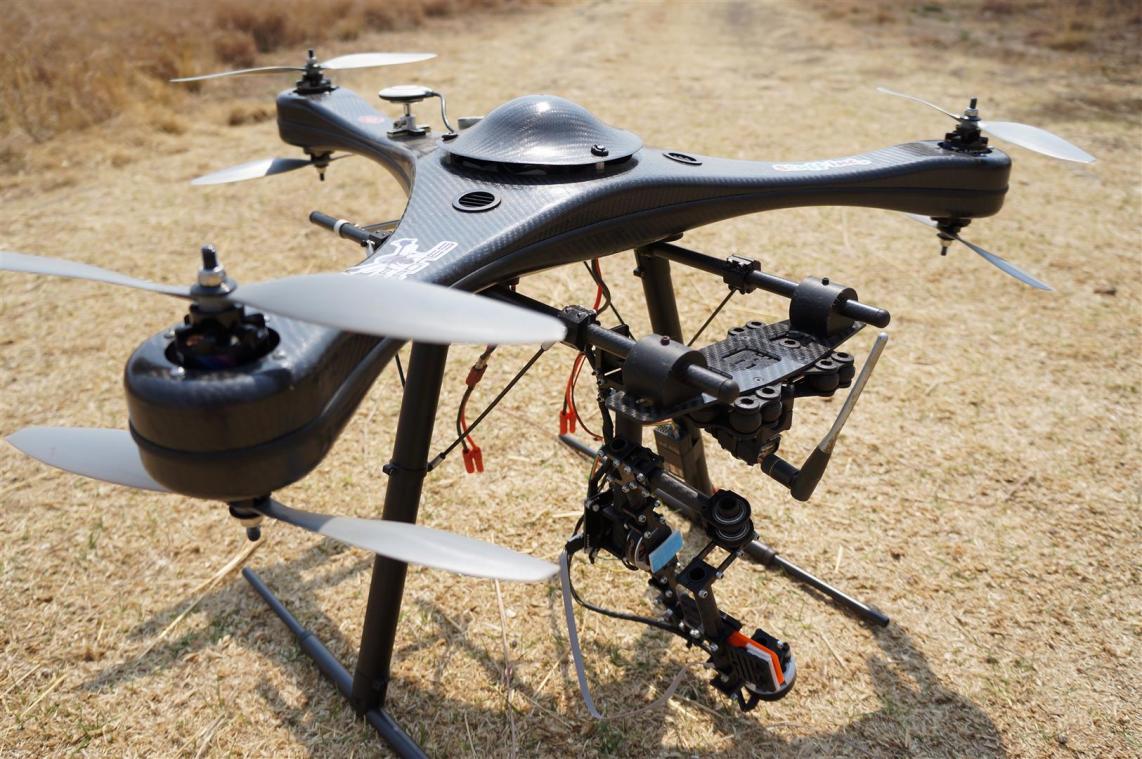

What size is your frame? Mine is 70cm (motor to motor) UAV frame extreme Y70.
How much vertical space do you have between props?
Are you using the same props top and bottom?
