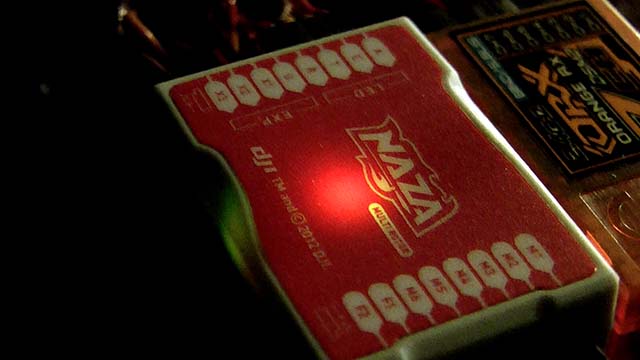

Hello Friends. This is my first post here and I have a quick question. I have the Naza control in a Gaui 500x and seem to be having a little trouble getting used to it's flight characteristics. I've been wondering about something since I flew it into the lake on my third flight. I noticed after repairs that the red LED in the MC not the VU has a slight flicker to it while the control is on. The transmitter is on and the multi-copter and motors still while sitting on the ground. The flicker is very slight and just noticeable. The craft seems to be flying correctly but I'm completely inexperience with this and can't be sure. I seem to be getting some drift which makes it harder to fly. Can anyone look at their MC and let me know if the red LED inside the case of the MC is rock solid or if there's a tiny random flicker?

Hello TooMany. I don't think we are talking about the same LED. The one I'm talking about is inside the case of the MC itself. It is only visible through the case and is red only. I mentioned not touching the sticks because moving them would certainly make the MC respond in some way. The flicker does seem to be random but it may be the processor checking status of any of the devices on board. I just thought of something. Maybe instead of asking you to look at the status of the LED on the MC, I should ask if you have a red LED on at all. Maybe I have one on because something is wrong. Do I know you. I knew someone in the Cleveland R/C club or the Corsair Club in Akron that has the same problem with the colors. Anyway. If this picture attachéd works things should be clear about the Diode I'm talking about. Just under the word Naza and it has a just noticeable random flicker.

Hi Dad, yeah I have the same light and there's nothing wrong with my 450 naza cept for the jaboni running the sticks. I think it's there to let you know naza has power like on your rx.
DadHav
Hey Jaboni at the sticks. Thanks I thought the same. There aren't many R/C devices that are without a power LED. The thing I questioned was whether or not it should be flickering while everything is sitting still. It almost looks like the control is initiating something with enough current drain that the diode dims slightly in a random manner. I hate to be a pest but does your LED stay on with a constant brightness or does it have a very slight flicker to it?

Thank you. I mailed Naza with the question, they referred me to where I bought it (Flying-Hobby.com) Flying Hobby told me to send it to them and they'd send it to Naza for repair. I couldn't even get anyone to understand what LED I was talking about.
