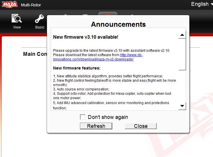

Hi Guys
I am puzzled!
Have been hearing its possible to upgrade to Naza V2 firmware on V2 hardware with the new Assistant Software.
When I try, I get the announcement that there is new firmware 3.1 available.
But after closing that announcement pop up, I cant seem to upgrade it because it says no update is available.
What gives???
View attachment 11667View attachment 11668

When I went through the process, I got a bit confused as well. I know I clicked on the No Updates text in blue, and then it actually did say there was an update, and I was able to download and update. I know it was just a trial and error thing that I did before I finally got it working. Oddly enough, even though I updated to the latest, I still get the "There Are New Updates" window every time I launch the software assistant.

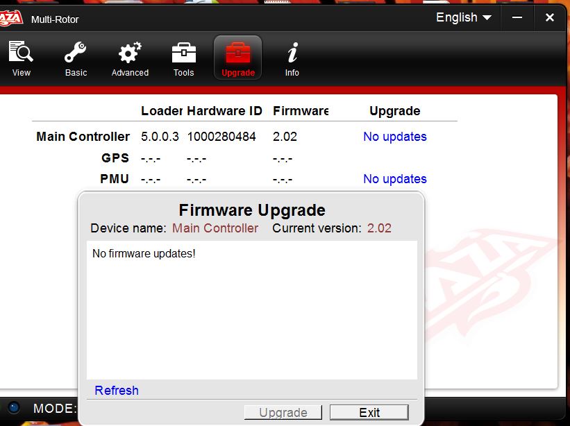

I did try clicking on the No Updates hyperlink...but I get a pop up saying No Firmware updates.
I am wondering if it has anything to do with my current firmware.
2.02, software 1.8.
When going to DJI website, I cant seem to find this software/firmware combination anymore. Have they pulled it?
Instead, I see for naza V1, the latest (V1) firmware/software is 2.01/1.6
I tried downloading the 1.6 software, but again can't downgrade the firmware to 2.01

I have now tried using the v2.1 software assistant on another older laptop (previously was trying on windows 8).
I still get the same problem....it reads my firmware as 2.02 but when clicking only 'No Updates' hyperlink,
it says no upgrades available.
May sound weird, but I wonder if it is a case of maybe DJI is limiting upgrades geographically?
I live in Singapore.
The other thing I find weird is how come Software Assistant 1.8 (FW 2.02) is no longer on their website?
Still was wondering if I needed Software 1.6 (FW 2.01) to do the upgrade to 3.1 firmware...but even
then, Software 1.6 refuses to downgrade my firmware...ie, the process checklist where they show little
green circles next to the steps....i get red crosses at Athentication onwards

got the same problem using Software Assistant 1.8 (FW 2.02) it reads No Updates available
i just found this post at rc groups
http://www.rcgroups.com/forums/showthread.php?t=1536553&page=1318
About Naza-M V3.10 firmware
Since the Naza-M V3.10 firmware has been launched, we received some feedbacks that the aircraft cannot be armed after updating and the center position of the stick is abnormal.
We currently suspended the upgrade of firmware V3.10. And DJI will release new firmware in the very near future.
For those who had already upgraded the firmware V3.10, you can use the Assistant Software V1.8 to restore to firmware V2.02, and you can download the software from: http://www.dji-innovations.com/downl...a-m-downloads/
but when you go to the link you get a 404 eror page not found
